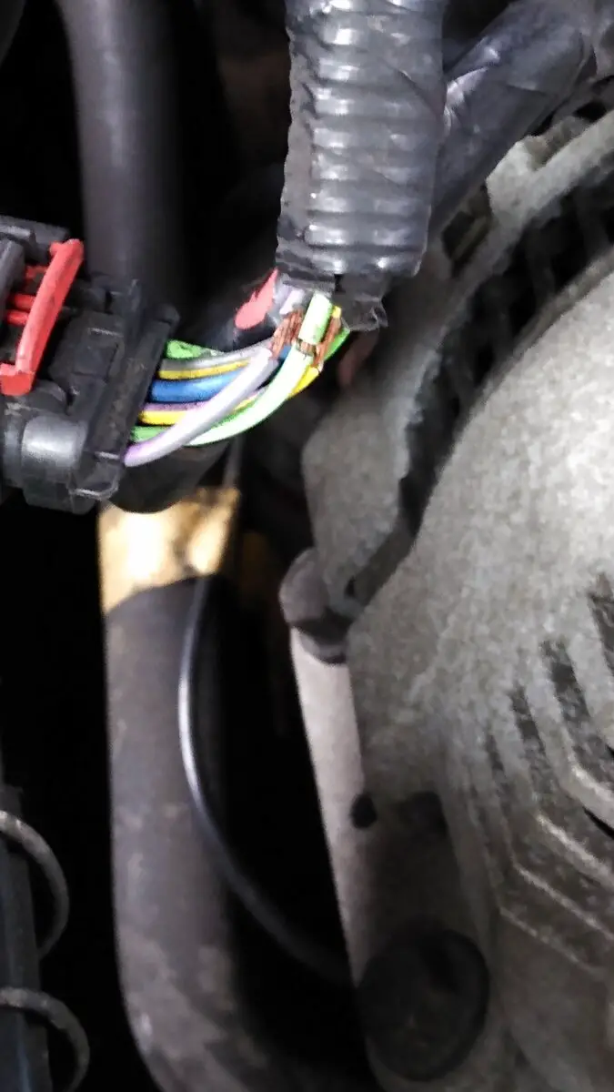

Check your wiring harnesses by the connectors. I was just going through my kid's 07 4.0 and most of the harnesses on top of the engine (MAF, coil pack, throttle body) and even the one that went to the O2 sensor were brittle and busted and crossed. Every wire. I have never seen anything like it before, but some of them blew a fuse and sent a bunch of codes. You probably had to move some of those to put that water pump in.
The other thing... I do believe there is a wiring harness that travels beneath that water pump that goes to the alternator... might be something to check for.
This is the same thing I was thinking. I found this on mine after changing something and fixed it before any issue showed it's head.
