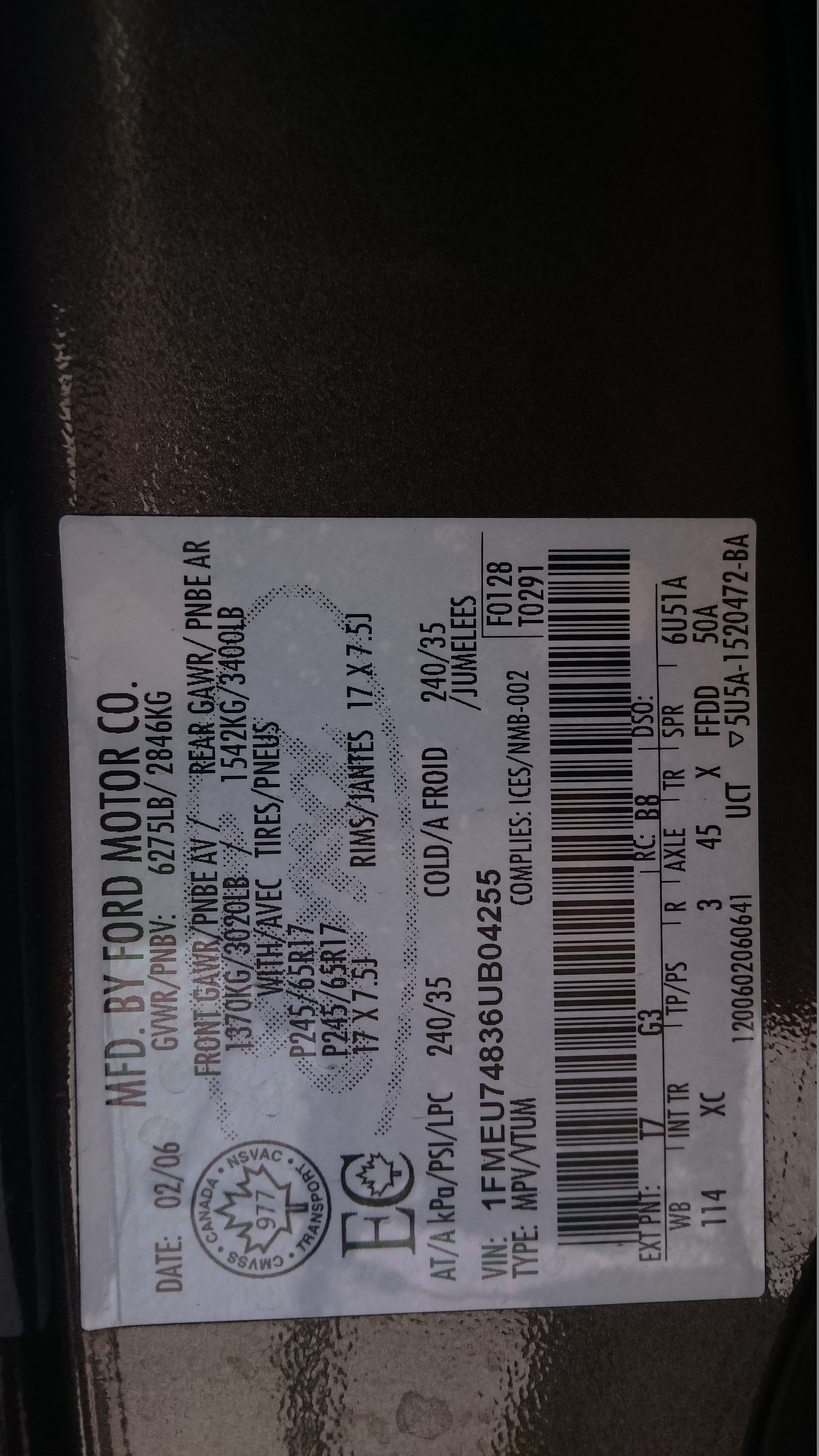

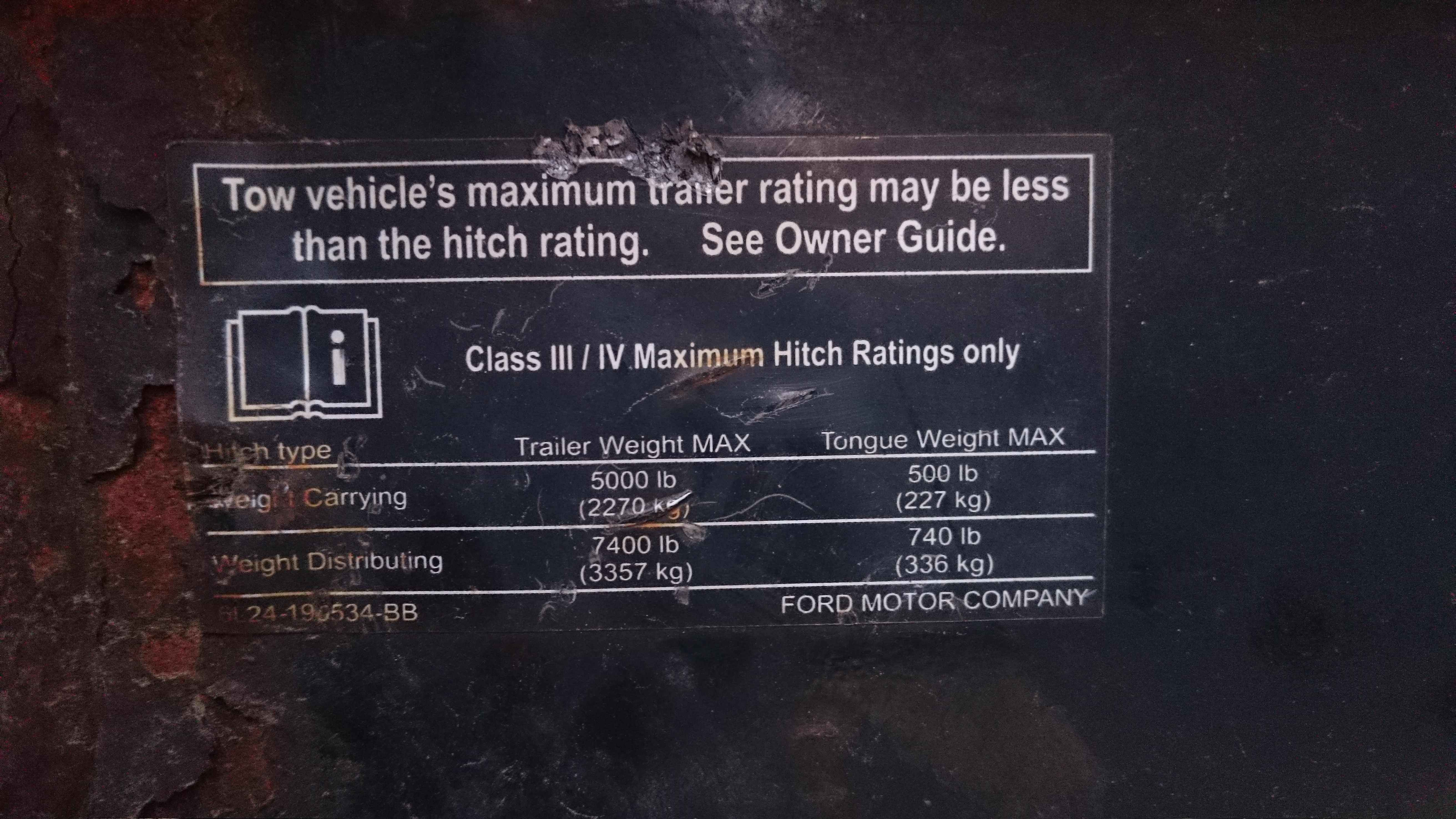

Getting back to some or the original discussion, note that the '06-'10 V8 with 3.55 axles gets the full 7000+ tow rating, because in '06, the V8 drivetrain changed from the 5-speed auto to 6-speed. The V6 kept the 5-speed, so it still needed an axle upgrade to get more towing capacity.
1st gear in the 6sp is much lower than in the 5-speed, so re-gearing the axle wasn't necessary. And 6th gear is better for gas mileage than 5th in the 5sp. In fact, V6 and V8 with 3.55 gears got about the same fuel economy. V6 with 3.73 axles returned worse fuel economy than the V8. The bad thing about this gen is that the OD-off button locks out both 5th and 6th gears. There is no way to lock out 6th only, which drives me nuts when towing.
