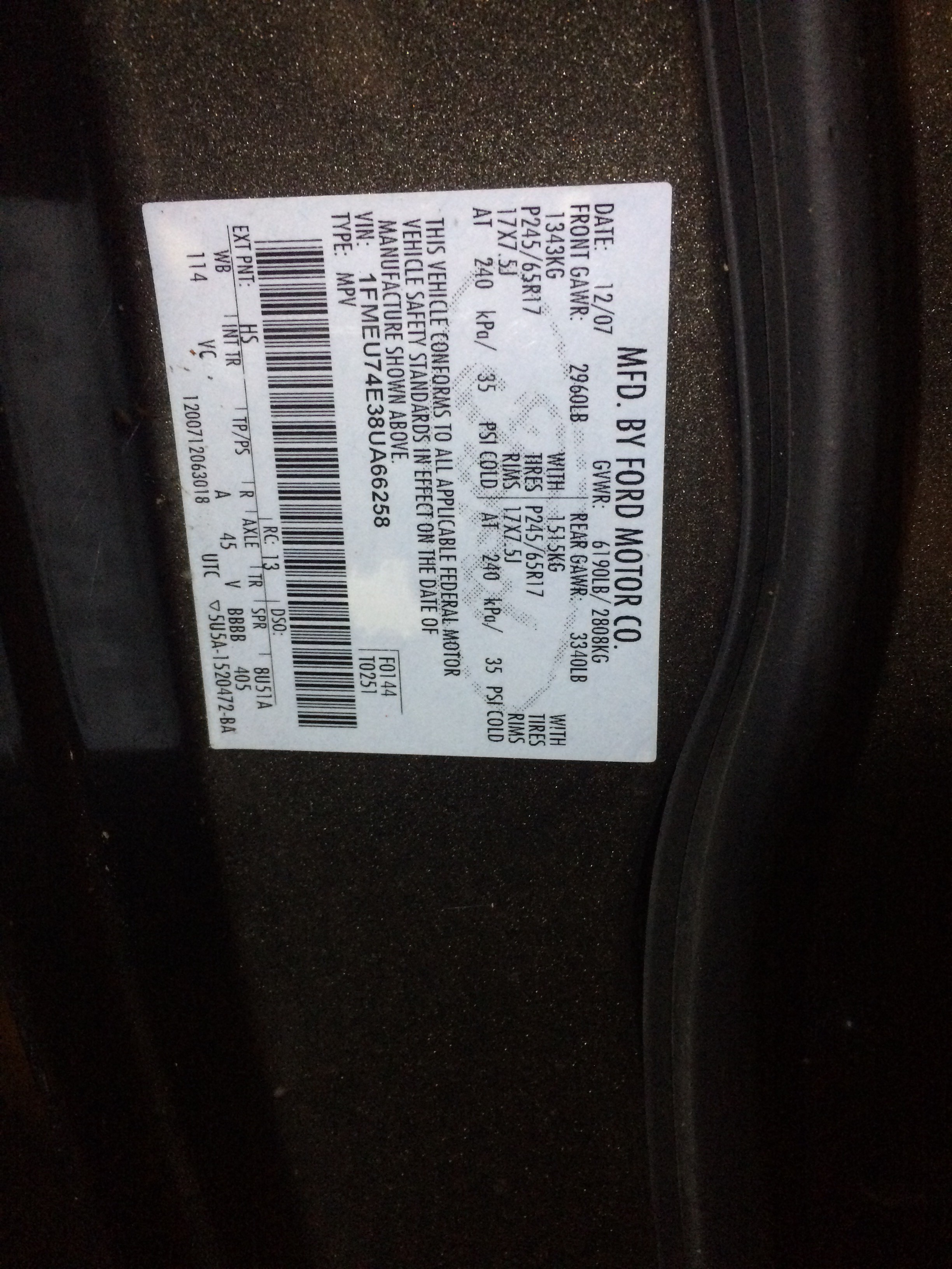

OK, You folks have me questioning my own setup. Since it was purchased from an Estate Sale, I really don't know its history, other than the few repair receipts and all of the oil change receipts the guy left in his glove box. 2008 Exploder with 4.0 SOHC, Open axle and 5R55S transmission, has a Ford Class-II Hitch (3,500lbs/350lbs Tongue rating) with a 4-pin harness connector that has a pig-tail rubber cover to keep it from getting nasty, and an ATF Radiator located at the front of the Radiator that appears factory installed. The ATF Radiator has the number E761S stamped in the top radiator mount. The GVWR Tag is attached below. Wondering if this is a factory install or just a dealer add-on?
Thanks!
Jordan
I see GVWR mentioned in every post but I do not think that helps. You need to know GCWR to determine what you can tow and that is not listed anywhere in the car.
