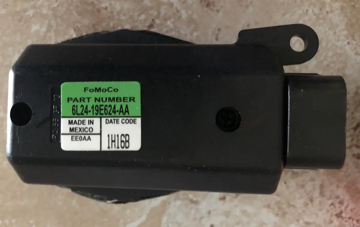

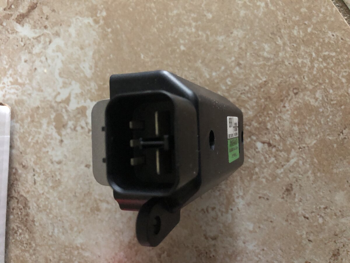

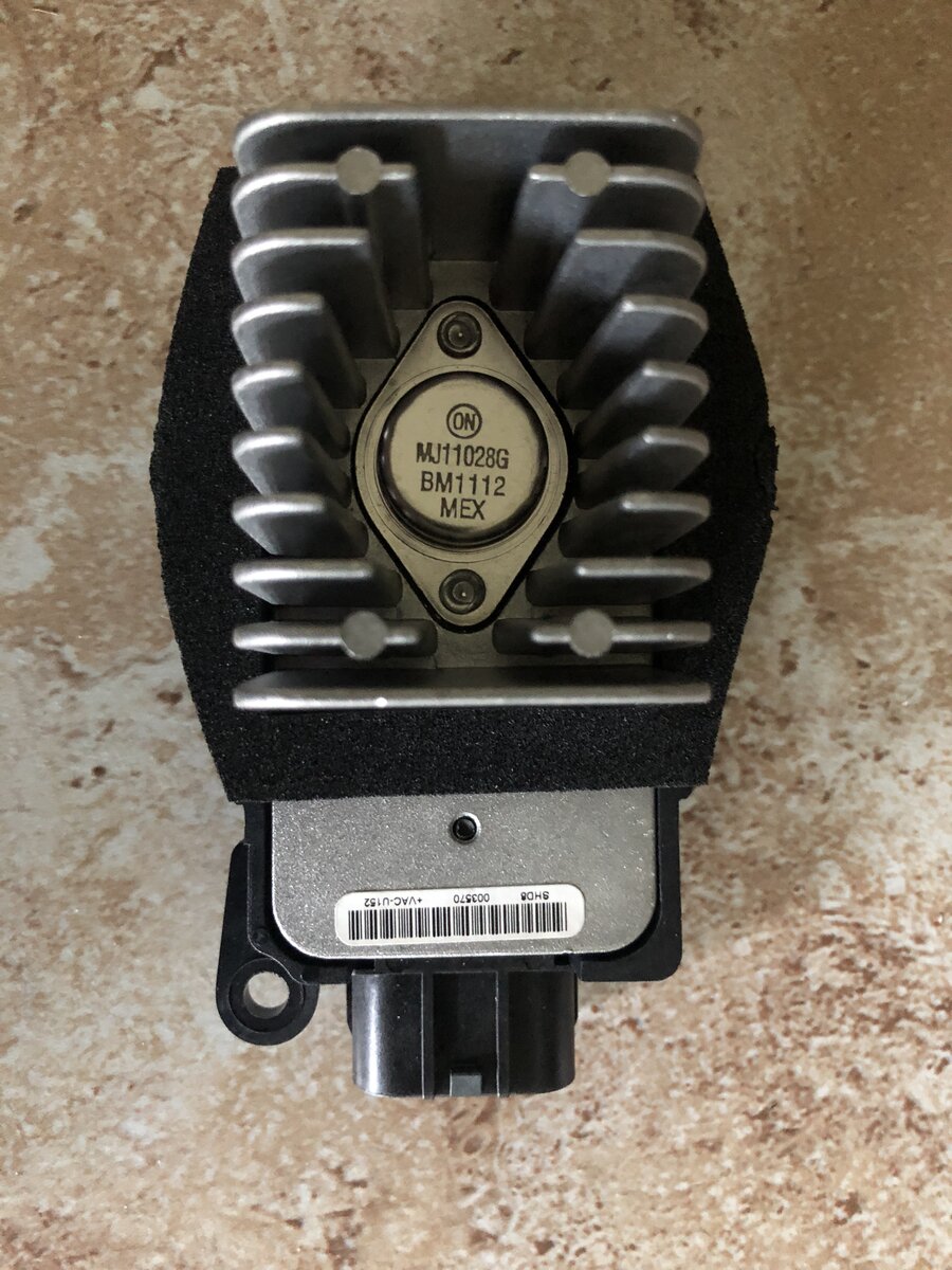

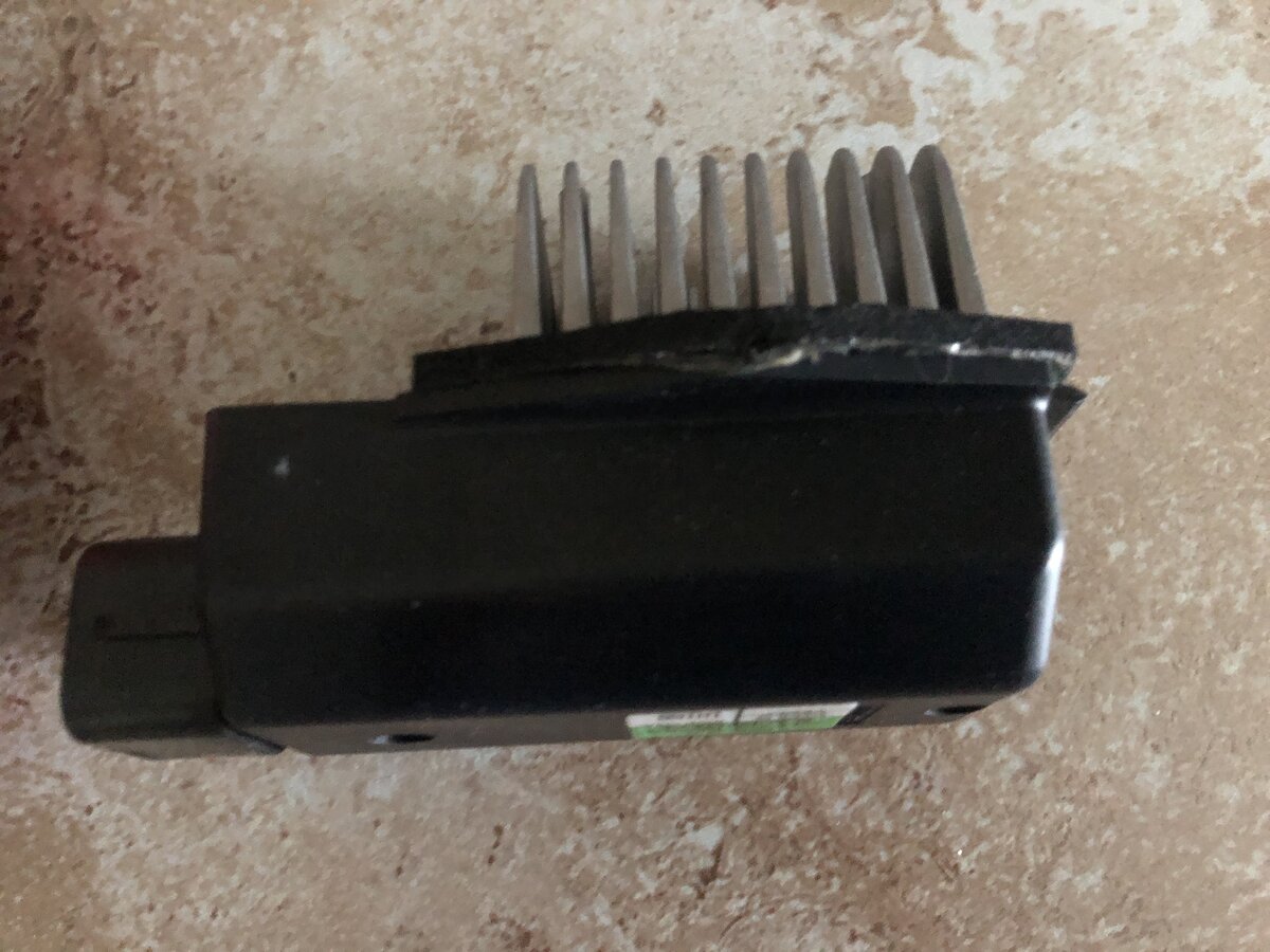

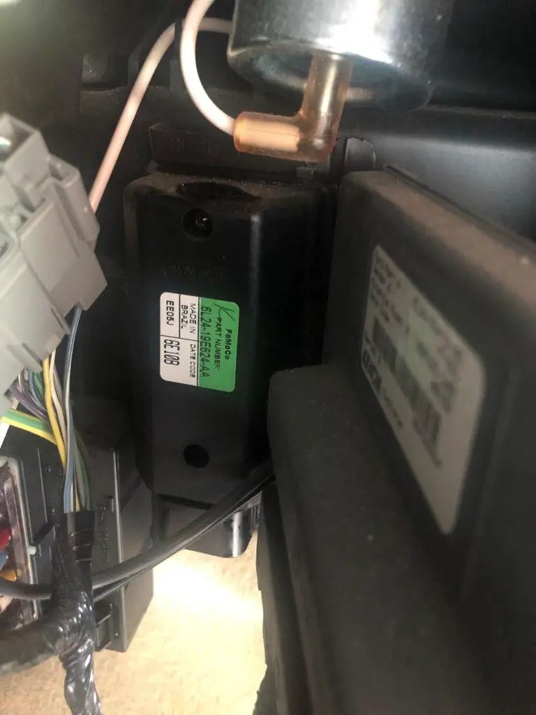

2006 Ford Explorer Limited 4.6 L, V8- I got $95 eBay new part by making a search for “YH-1822”, “YH1822”, only and waiting for someone in the US with a return policy. My symptoms were that the Dash Fan AC was Running at only highest 2 speeds/loud but this part added back ALL fan speeds. The mid seats roof blower was not affected by this part & always worked well. Squeeze the glovebox sides toward the glovebox center to hinge it down, remove 3 screws of glove for working easier, squeeze the electrical connector in direction of front to back of Explorer, seems near the firewall, to remove that electrical connector. I noticed on the YH-1822 that the cooling fins and the face between fins and connector will get HOT at about 200 Degrees F. so be careful and take those precautions & finish the swap per best practices.
Here is the numbers on the firewall side you won’t see of the newer YH-1822: “SHD8 003570 +VAC-U152”. From cab you can see a green sticker like “FoMoCo PN 6L24-19E624-AA, Made In Brazil (original) Mexico (newer), Date Code 6E10B (orig) 1H16B (newer), EE05J (orig) EE0AA (newer)”. Apologies if confusing, just want to give back.
