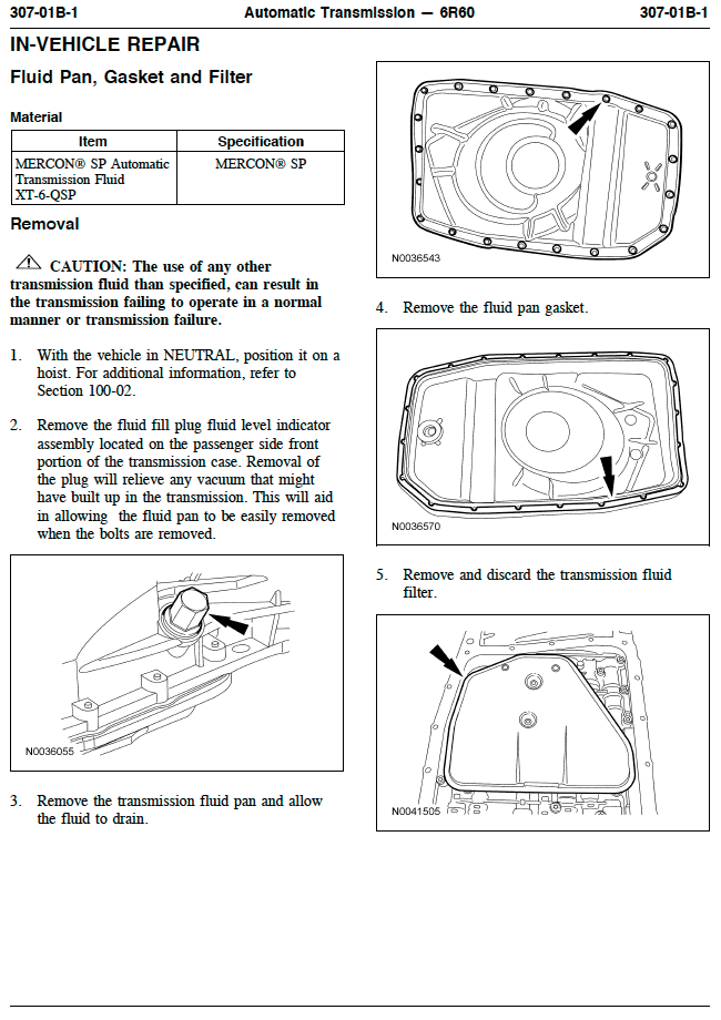

Don't forget the filter replacement. That may very well be causing your current problem.
Thanks for the suggestion. By the way, is that gasket reuse able on the pan?
Congrats on getting the plugs out. That's a little concerning about leaving porcelain in the cylinder.
Better be extra careful with the trans fluid change. Apparently, the gasket is reusable:
