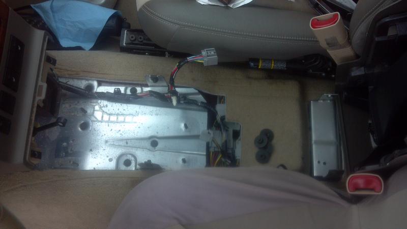

Hmmm strange. What I would do would disconnect the shift cable at the xmsn, and with the help of a friend, manually move the lever to each position and drive it to see if it selecting the proper gears. if it drives fine that way, i would probably pull the shift cable out and inspect it for any damage. Maybe replace it just for the hell of it. Also I would recommend removing the entire center console and shifter assy and give it a thorough inspection. Its pretty easy to do and takes less than 30 minutes. Here's a pic of my shifter and console completely removed from the vehicle. you can see the end of the shift cable.

..... Its pretty easy to do and takes less than 30 minutes. .....
That's pretty funny, TMQ. It probably took me 30 minutes just to get the top cap off my console. I'm sure I could do it quicker the next time but to strip it down like yours....???? I guess I would make a poor flat rater.
Lol. Boomyall. I wish I had my Explorer with me. I would make a tutorial. I plan on doing a few how to threads when I get back home.
Well, I'll be standing by, with 'bated breath, awaiting your production. Without one I would undoubtedly spend near a full day futsing around with figuring it out.
