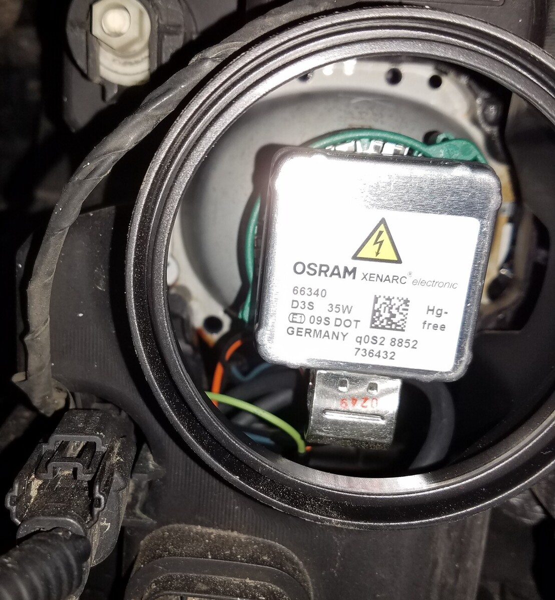

No wire going through the boot. I pulled off the boot to see the back of the bulb and this is what it looks like.
Ok that’s weird. It’s the same bulb as the factory HID setup but the factory doesn’t use that green ring on the back to secure it. Factory uses a flanged retainer that is screwed in to the projector using t10 torx screws.
The previous owner may have added the ballast and bulbs but adapter the D3S HID bulb to the 9005 bulb base using the green adapter. The housing is the same for non hid or hid so there is a spot on the bottom of the housing for a Osram Xenarc D3S ballast.

PM Sent. I did a google search and see there is a 9005 to D3S conversion ring that clamps around the D3S bulb. Maybe that is what the previous owner did.

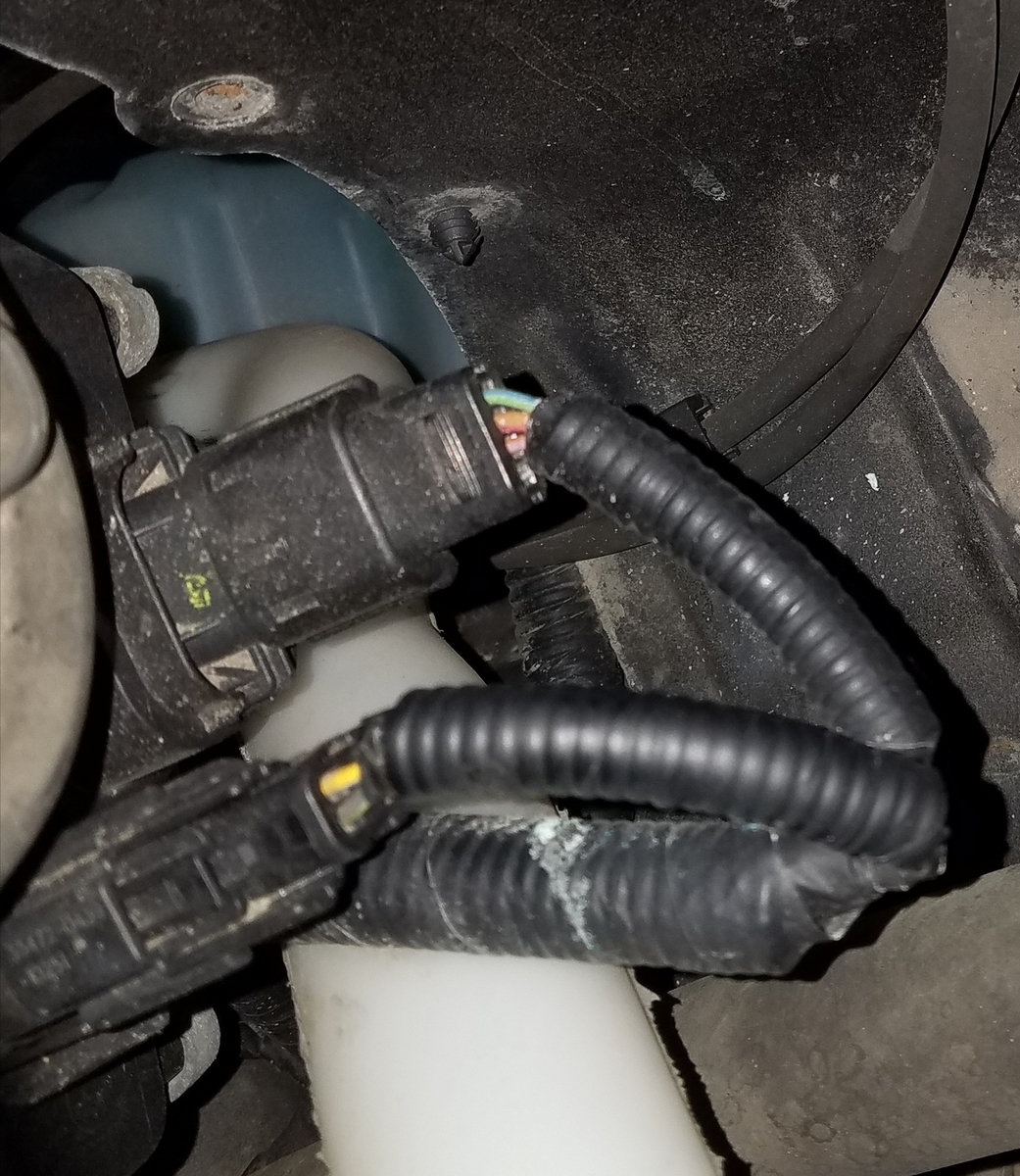

Ok here is what’s weird. Your car doesn’t show having adaptive cruise, active park assist, or blind spot detection (all components of the 302a package). But the build data does show as having High Intensity Discharge headlights. Again this is only available as part of the 302a package. I have no idea what’s going on here. Can you take a picture of the 4 wire plug on the back of the headlight assembly showing the colors? I think the wire colors were different for Hid vs halogen.

Those colors match with factory HID wires. Man this is odd.
So assuming they are Factory HID, which based on your research on the build sheet they are, I wonder why the bulb doesn't mount in the housing like you mentioned above with thetorx screws.
Lol, maybe they ran out of the HID housings at the assembly plant and used these green adapter rings to put them in.
Could they be dim because of age? If they were original bulbs that would make them over 6 years old. I'm wondering if they are worth replacing just to see if I can get more light output.
The mount definitely looks off. Maybe 2011 had a weird mount.
