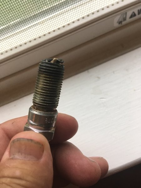

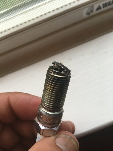

This is the spark plug so I need a camera to look and see what caused this the piston looks good but I also found metal in the cyl 5 so 5 and 6 are contaminated her husband changed the plugs and m
Nice. Did you get an inspection camera in there? Turn over? Compression?
I have turned it from the crank bolt with a bar and it stopped turning, it will not turn over with the starter I have to borrow a inspection camera
Are those the correct spark plugs? Looks like maybe the first four or five threads extended into the combustion chamber. Is it possible the plug was damaged when the piston hit it?
That was my initial thought also and believe me I looked up the plug number that’s on the plug and I went online and I did the research and I looked up the correct plug so I even went to a parts Store and ordered a spark plug the same number 12 - 5 Motorcraft platinum
Also when I pulled the spark plug on number five cylinder, there was a piece of metal lodged between the plug and the electrode, The metal was about a quarter of an inch and a eighth of an inch long something like that in about a 16th of an inch wide somewhere along those dimensions it was like a small rectangular chunk of metal
I don't think I've ever pulled a plug that didn't have some carbon/discoloration on the first few threads (they don't hermetically seal against the combustion chamber). The way the first two threads are damaged though seems to indicate they may have been damaged from impact with debris in the combustion chamber and potential for internal engine damage.

As it is, you have a damaged plug and an engine that won't turn over. You can either get a camera in their and inspect and/or remove the head, or you can just write it off and replace the engine depending on your skill level, what you charge and/or what the owners are willing to pay, how soon the owners need the vehicle back on the road, or whatever other considerations need to be made.

Actually it is a friend of mine’s car, and because I found a piece of metal in number five cylinder and the spark plug is pulled from number six cylinder I am not entirely certain that the guy who change the spark plugs didn’t drop metal into the cylinders
