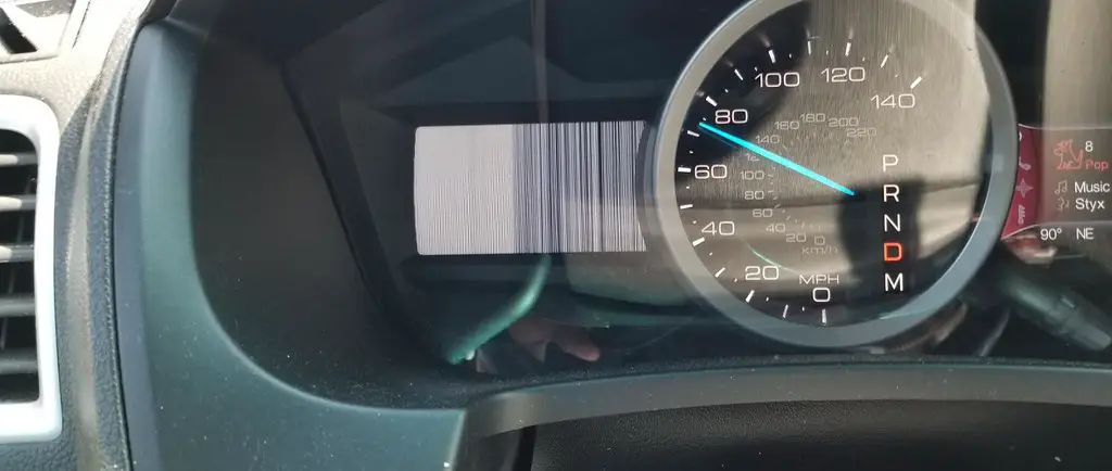

Got in my 2013 Explorer on Saturday morning to go somewhere and the display on the left side of the speedo looks like this...
display by Dean Smith, on Flickr
Tried removing the battery cable for 20 minutes to reset/reboot the system with no luck. Anyone ever seen this?

This issue has not come up before but judging by that picture I would guess that you will require a new Information Display. Looking at the parts site, it looks like you may have to replace the entire cluster. AutoNation Ford White Bear Lake | Parts & Accessories

Dealer says short in the panel, wants $1,100 to replace part and labor. Found one pulled from a wrecked 2013 on ebay. Will it be just plug and play? Mileage comes from the ECU correct?
Mileage is stored in the cluster.

I did get mine fixed, I.E. replaced the cluster and programmed the mileage at the dealer. I had about 88K on it when it went out.
