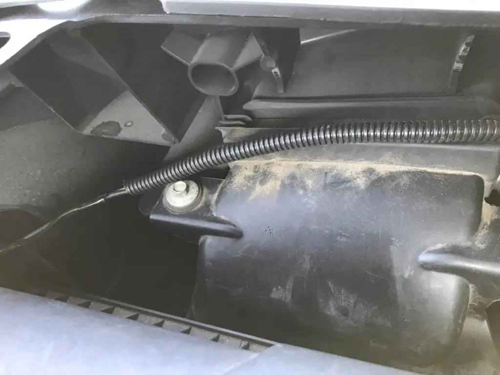

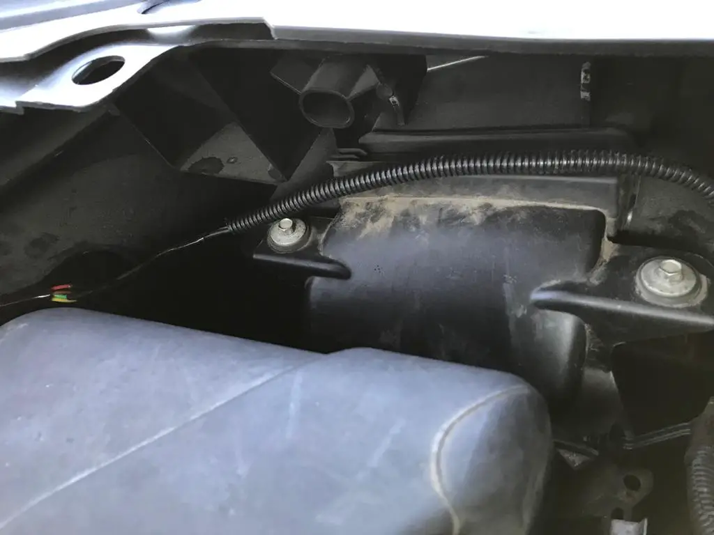

Hi,
Can you help, I can't find the place Technerd is writing about,
For me it looks like in the pictures. (You can see the cable there, but this is the fog lamp harness)

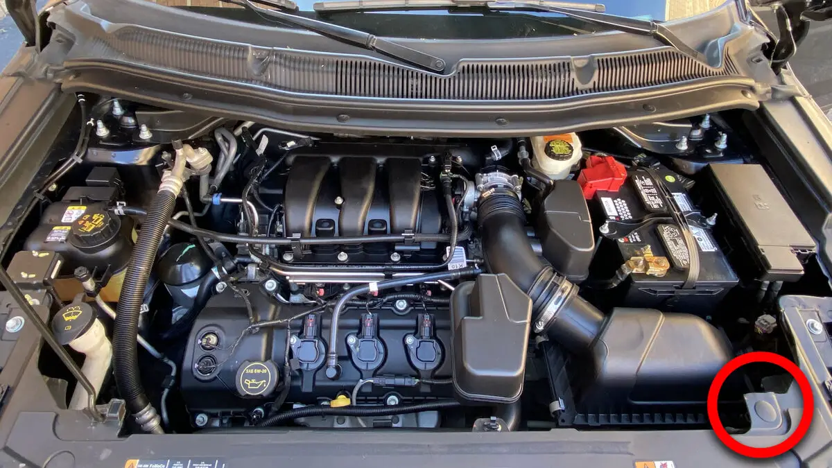

I would say the switch would mount where the opening is in the top left of the 2nd picture. Here is a picture of it in a 2018 Explorer. Look at the middle right for that little rubber "Christmas tree" by the Airaid filter.
Peter
Ok Peter thx,
I don't think I understood Technerd;) sorry,
I thought there should be a wire to which I would connect the sensor, but the cable is not there. The plug is gone, the hole is there and nothing else. Could it have been removed?
(Sorry if the questions seem trivial):
How, then, does the Remote Hood Sensor communicate with the car ignition / engine? Wired or wireless?
If I don't have a wire there, where should it go and be connected?
Thanks to everyone for your help;)

13. Install the hood switch. It is located near the front of the engine compartment on the driver's side near the headlight. Or make a test jumper from a short piece of wire and insert it into the female side of the plug once you have disconnected it from the dummy end.

19. Remove test jumper and install hood switch.
This was how I did my truck, I programed the lock/unlock first to make sure the remote key worked before proceeding to the remote start programming. My key works for a good distance. Hopes this helps, your mileage may vary.....
