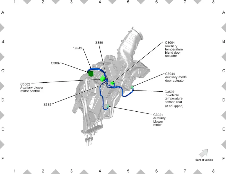

I have a 2013 Explorer XLT and the rear ac will not blow cold. When I turn it to hot the temperature of the air does not change. I can not find any info on this. Any help pups be greatly appreciated.
Welcome to the FOrum Travis. :wave:
It is possible you are having issues with the blend door or the actuator. I'm guessing that the blower motor is working?

yes blower motor is working and I was able to pull the temperature actuator and it seemed to be working fine.
