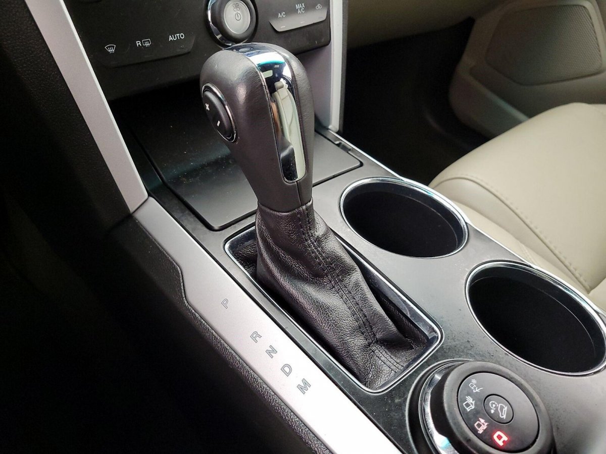

Looks like I'm about to buy a 2014 4WD XLT from the local CarMax... I'm curious as to how the 4WD controls work... I test drove it once and wasn't sure how nor did the CarMax salesperson so I left it alone. The 3-4 Avatars on the knob are about as clear as a muddy stream... One has a tree? One has a cactus?.. The other kinda looks like a slick street? and there's a center button, too showing going downhill?

4. In the picture below, one avatar is lit up... Can I assume that's the standard 2 wheel drive that I'll spend most of my time in?

The 5th gen Explorer really doesn't have true 4WD. It has what I believe they call "Intelligent 4WD" which means that the system will engage the 4 wheels when it senses the need for it. I believe the closest you might get to having 4WD is if the drive mode is put into the Sand mode.
The Explorer is FWD biased.

Wow.. Very helpful, Peter! You da man.. The video answered all but one question.. Very odd that they didn't point out what the center button is for... Do you know? ...
