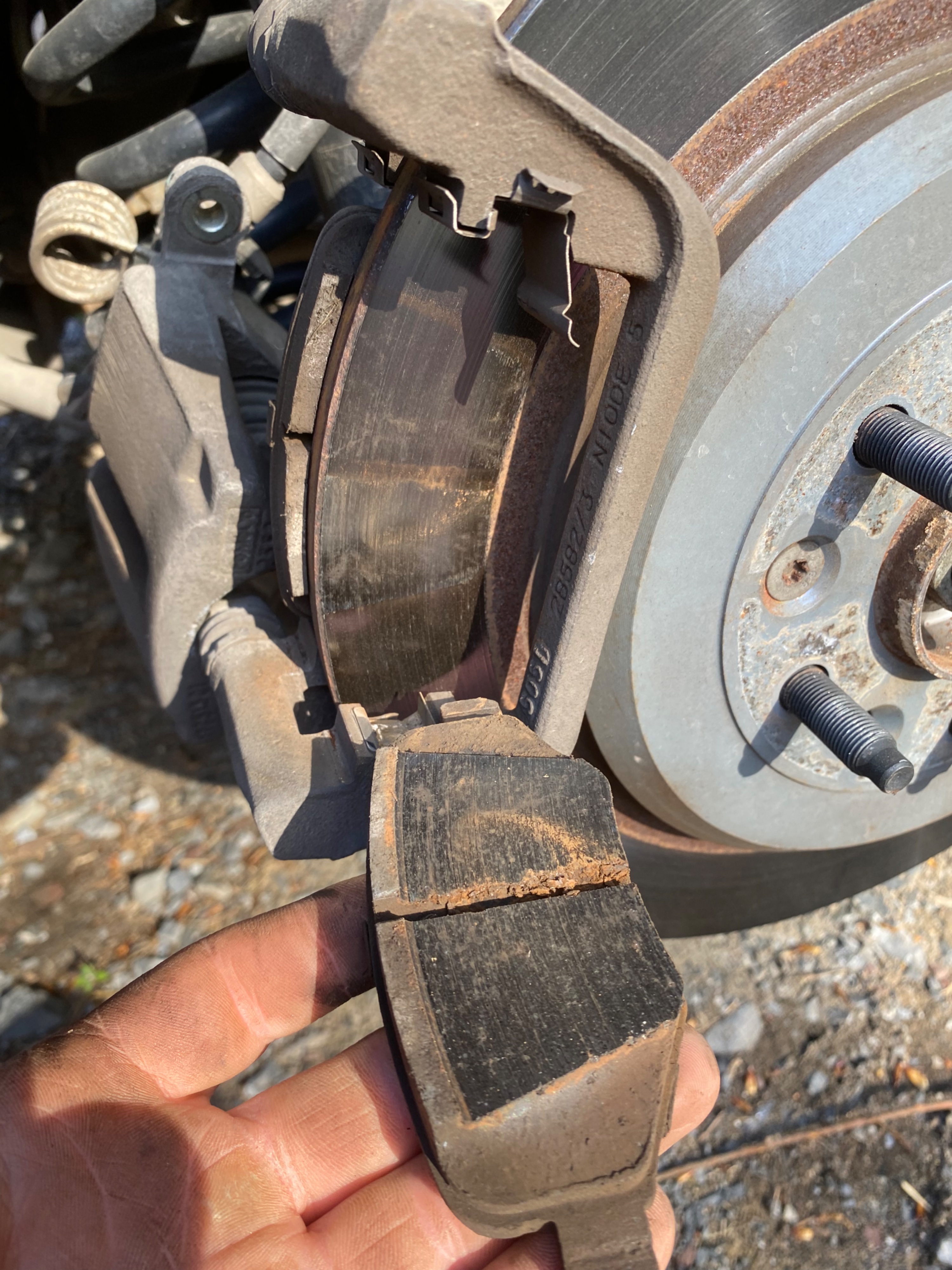

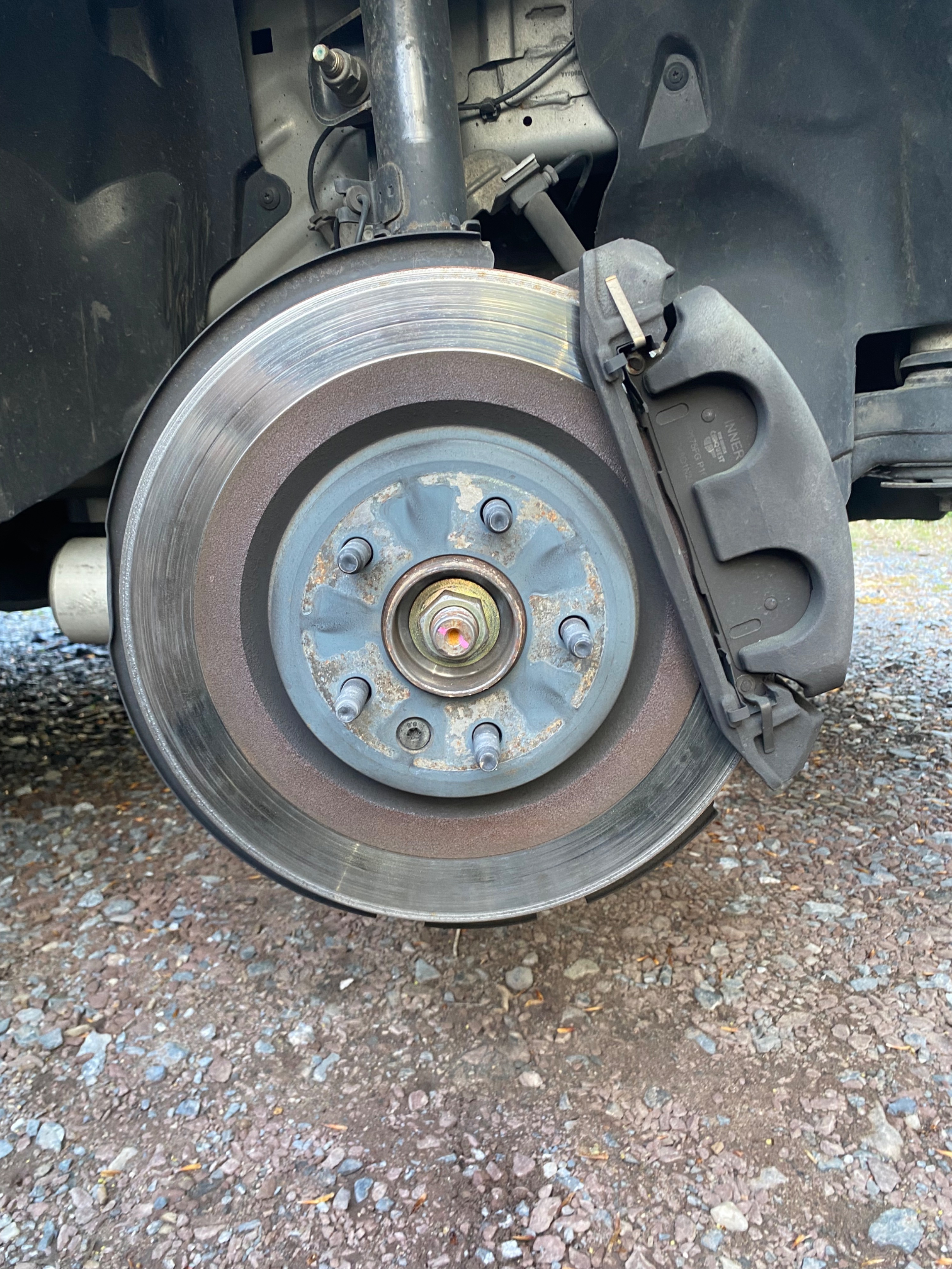

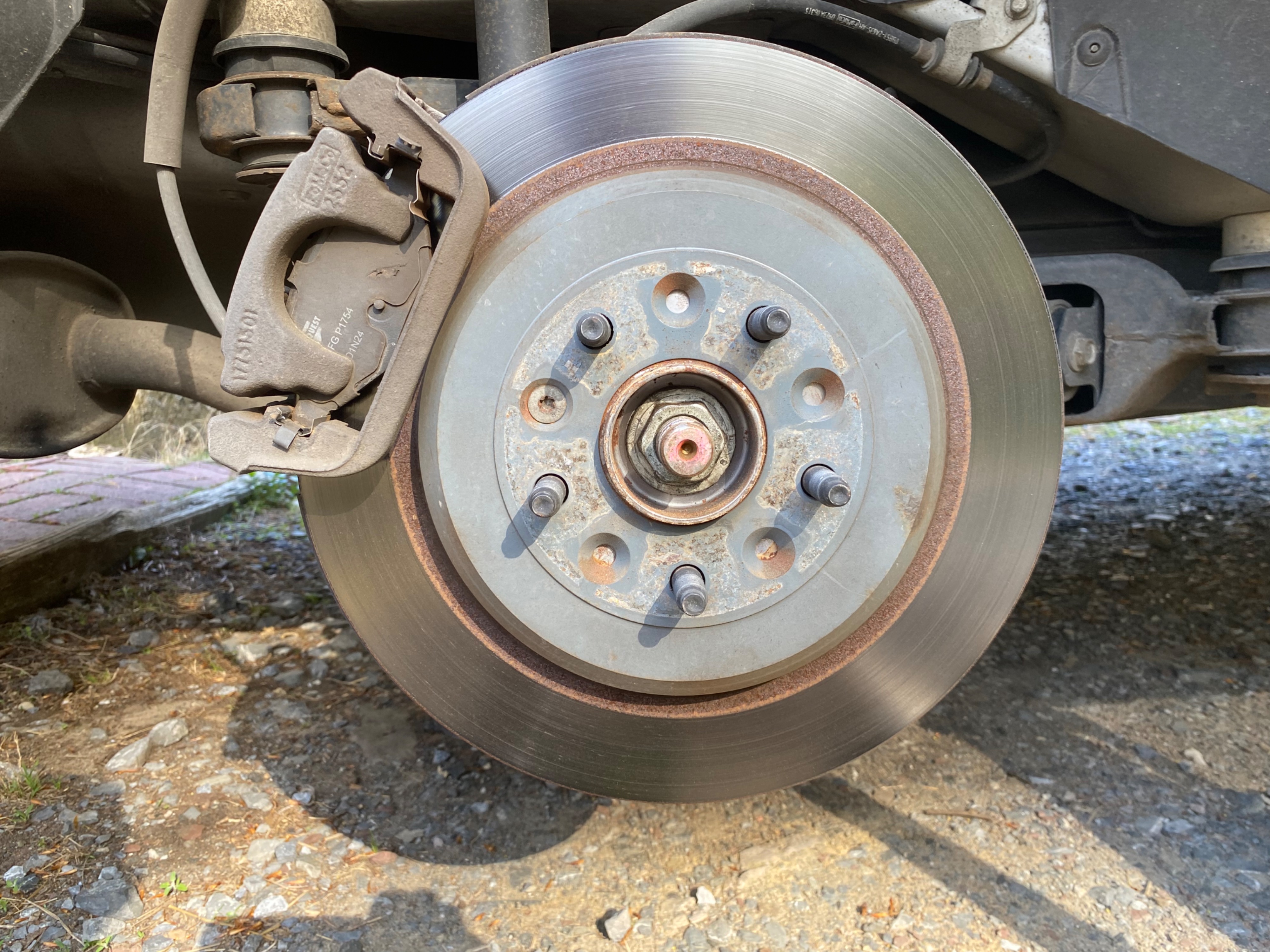

2015 Ford explorer sport rotor problem. The wrong rotors were installed 325mm. When you use the vin it shows 325mm I did not install them someone else did. A lot of stuff I read says front and back 352mm or front 352mm and back 345mm. with the 325mm installed there is about a 3/4 gap between rotor and caliper bracket on the front. On the back there is about a 1/2 gap. I am assuming 352mm fronts and 345mm backs is what makes sense here. Everything on Rock Auto is either 352mm or 325mm with the exception of one listing for a 345mm. let me know what you think.
Ok added these pictures in first two are front second two are back.

Do the pads ride fully on the rotors? Post pics.
The front ones definitely do not ride fully on the rotors. These rotors and brakes have been on for awhile installed by someone else. I do not drive this car and was not aware of this until recently it was in the shop and the had a note on the sheet install correct rotors it was in for inspection. Surprised they passed inspection like that. So pretty sure they are 352mm fronts because its either that or 325s and the 325s are wrong. I cant find anything saying it would be a 352 front and a 325 back either so I think its 352 front 345 back. The shield behind the rear rotor is smaller and the caliper bracket is closer to that rotor then the front and that rotor in the back is currently a 325 also. I didn't take the rear wheel off I will take it off and look tomorrow im assuming its going to be hanging off that rotor slightly less then the front ones. let me know what you think thanks for your response much appreciated. This vehicle has a hitch on it also if that's helpful. Thanks again
There are two options for your brakes standard and heavy duty. You need new rotors and pads front and rear due to the standard fitted previously. Do not get off track with caliper bracket to rotor and other such things. Order the HD kit front and rear for 352mm fronts with vented rears.

Also you need to fix the shield on your front brakes. In the Pic it is bent in a bit on the left (rear side) in the pic.

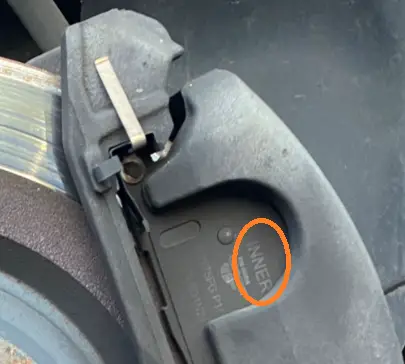

🤔 That's one of the worst brake jobs I've seen in a long time, and I've seen some bad ones. Whoever installed those pads could easily see that they overhung the rotors. They should also have seen that they were installing the pad labelled "INNER" on the outside. If I had paid for that work, I'd be really tempted to send those pads & rotors back through their front window.
Not only is that completely wrong, it’s dangerous.
I’d be concerned the part of the pads that are overhanging at the top contact each other, preventing the pads from compressing onto the rotor causing poor braking performance.
Not sure of there’s enough pad material for that to happen on the front, but possible on the rear if it’s the solid rotor.

Yea it was eye opening to see what happened there it was a relative.
