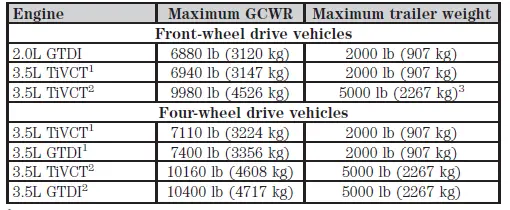

Do you have your Owner's Manual? There is some helpful info in there about this and towing in general. The following was taken from page 275 of the 2nd printing.

That's what I have in my manual as well, my question is which one applies to me?
3.5L TiVCT(2)
That's what I thought but I wanted to be sure
