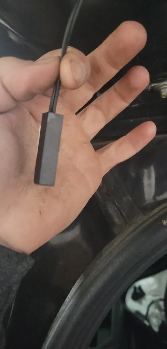

Hello I'm looking for some help, I purchased a 2016 interceptor utility (explorer) with 60k miles. Nice suv and in good shape. The issue I'm having is the trunk hatch. I do not have key fobs just a key. I can open the hatch with a key just fine. However if I hit the trunk unlock button and go to open it within 45sec it dose nothing. The light on the dash shows its unlocked. I tested the button it's good and the power wires show 10.7v if I feed it 12v with a power probe it works fine. Wires all look factory and good. I'm not sure what or where the issue is anyone have a idea?? I'm scratching my head.. thanks!
