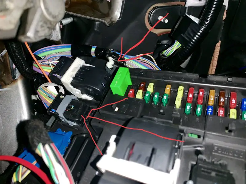

On a 2016-2019 explorer base XLT the BCM is where the hood switch wire plugs into. It plugs into the #14 location of the connector located with the lower red arrow. The top red arrow points to a harness restraint, that when removed will give you much more slack to work with. For more slack remove the top harness connector as well.
On the sides of the connector are two retaining clips (yellow arrow). Gently pry them out and slide the inside of the connector outward (green arrow). Pin locations are labeled.

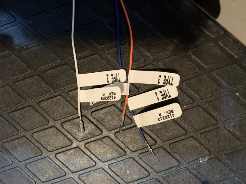

The universal harness kit comes with three connectors. Use the orange one (type 3) and insert in pin 14 in the proper orientation.
Now connect the orange wire to the harness you installed and have connected to the hood switch.
