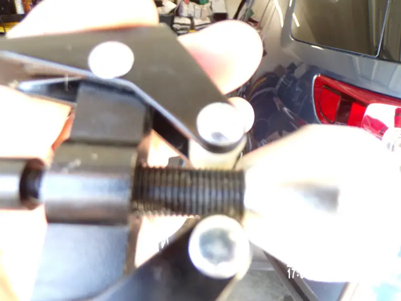

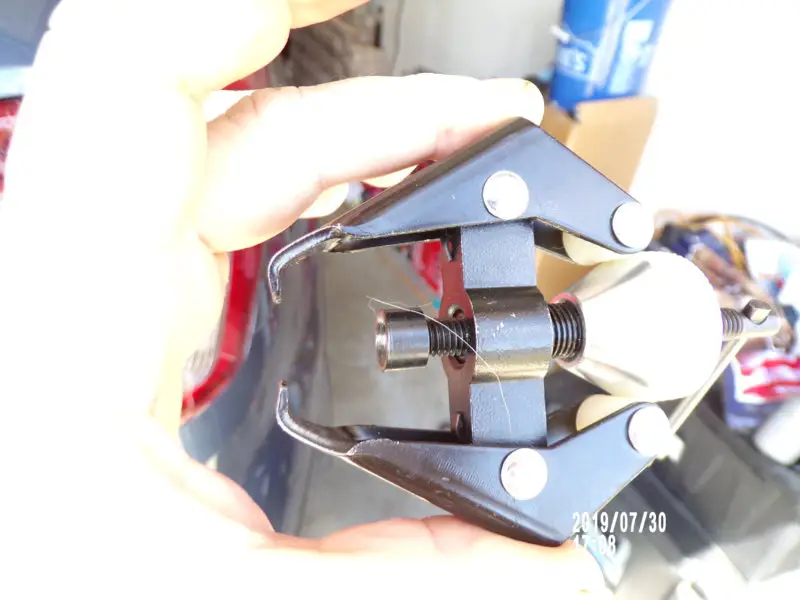

Gear Puller. Amazon look for the one in the photo it worked great. adjustable claws and adjustable shaft to gently remove from the shaft/stud.

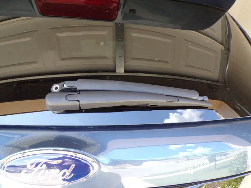

OEM Blade at top and "Improved" at bottom...

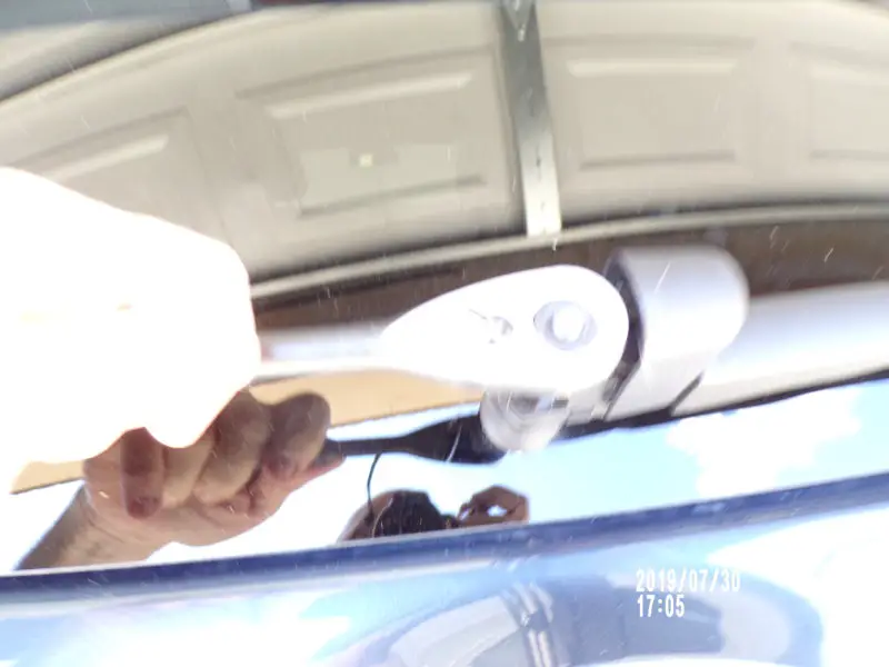

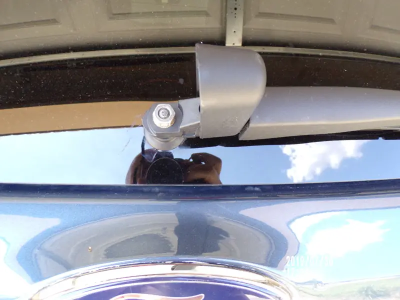

Removing the arm retaining nut cover.
Blurry I know but removing the retaining nut.
Puller turned full Counter Clockwise
Puller adjusted down.....This may not be the exact tension but you get the idea. The Knurled knob turns inward to keep tension on the claw feet to prevent from slipping off the arm.

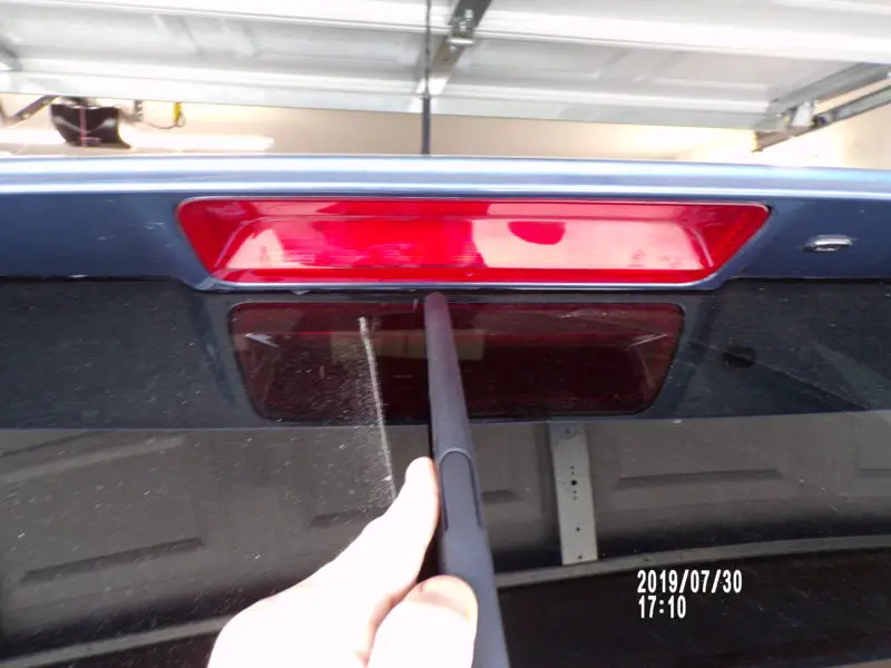

Finished product. The dust line is to the left of my finger the top of the wiper blade arc is close but does not contact the spoiler surface. I believe I had about 1/2" clearance. Blade was long enough to get the maximum effective sweep of the glass but not hang up on the spoiler surface.
