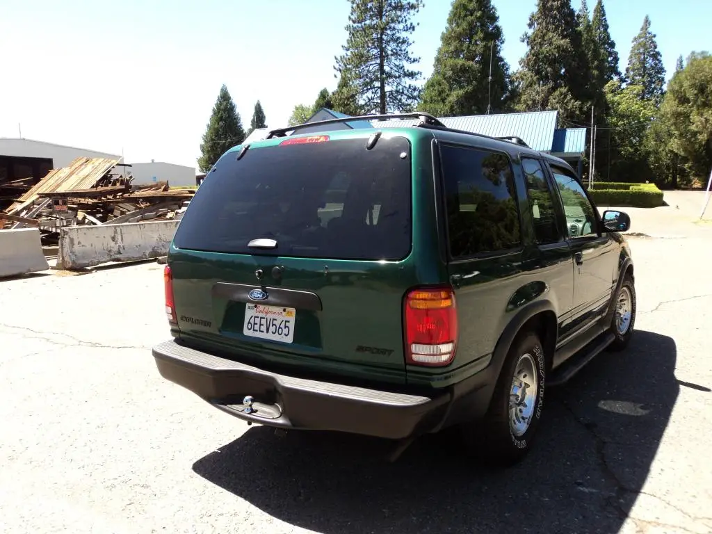

I got tired of messing with it and just eliminated it. A healthy application of RainX and I never have a problem with visibility. I would like to find a deflector to fit on it to help with any water displacement. Something like the Saleen spoiler or something similar.

I live in Northern Cali and it rains frequently. No issues with anything sticking to the glass. As far as inspections go, a rear wiper is not required so that's a moot point. Good for you that you spent some money and fixed your problem. I spent less and also have no problem. There's more than one way to skin a cat. I wasn't saying that what I did is the best way to fix the problem, just a different solution that works for me. Oh, and I use all of my mirrors the way they were meant to be used. Don't sound so much like a ****** nozzle. You have a nice day Sir.
