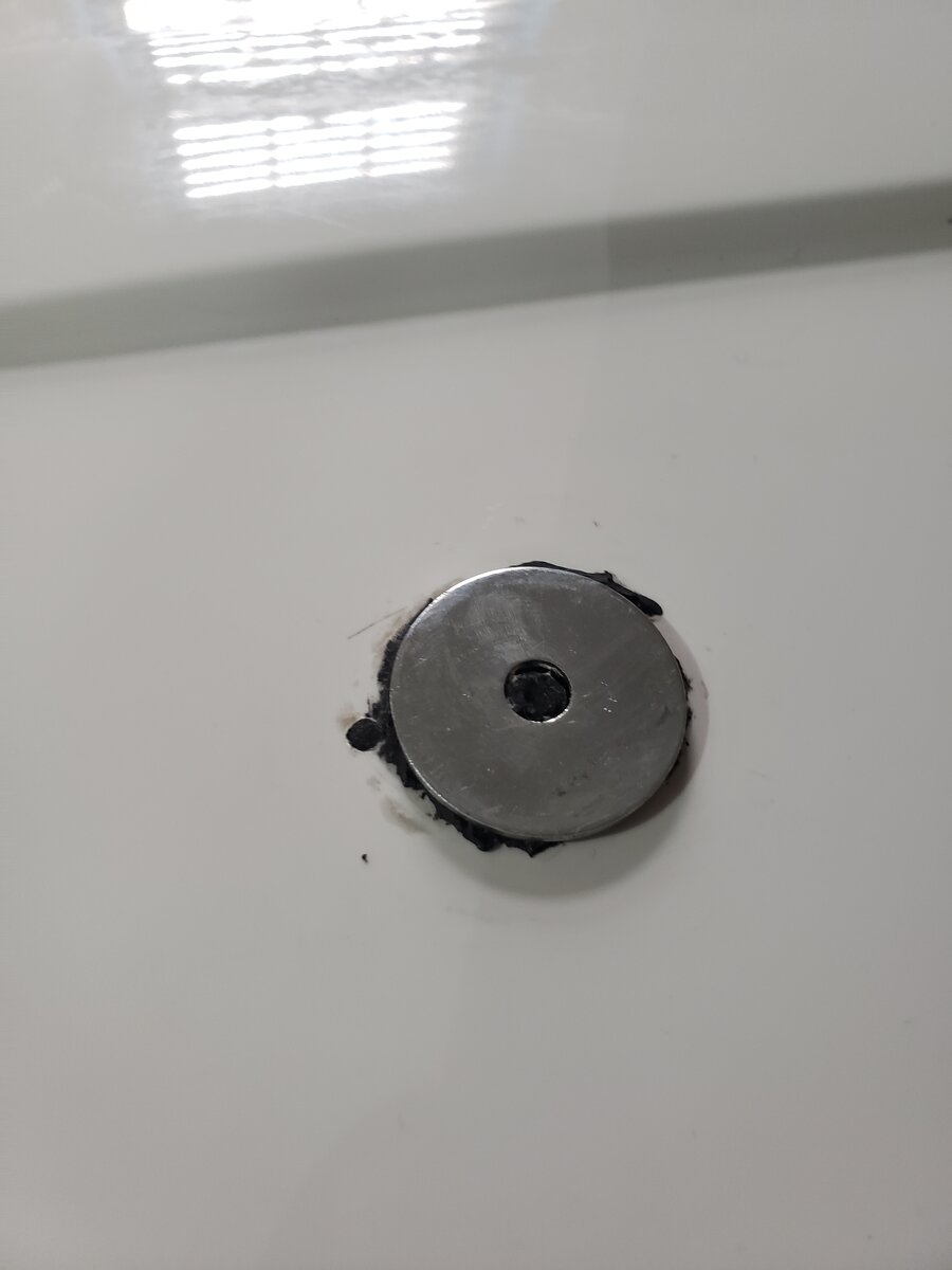

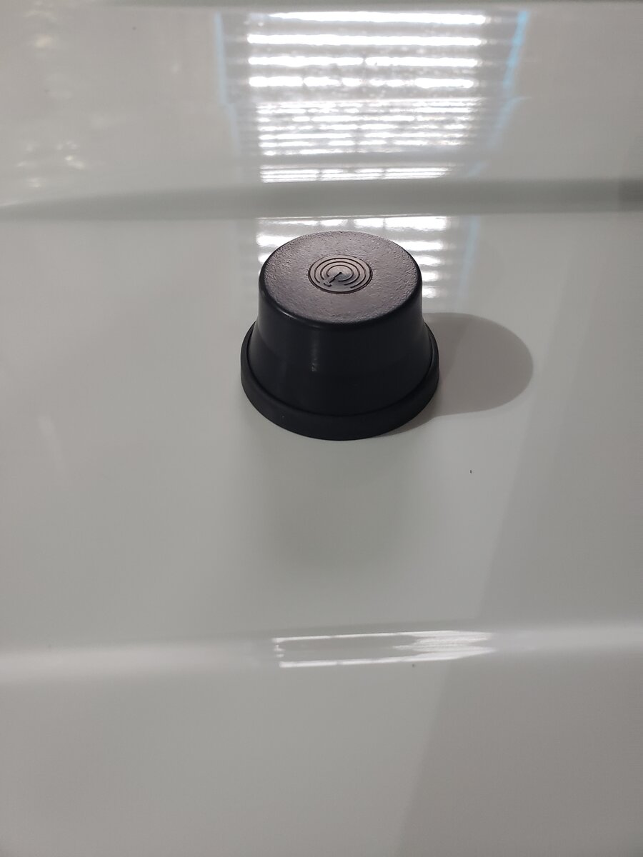

Posted already in Intro.My bad.Not sure what kind of mounts these are.Nobody seems to know.I have nmo mounts and rain caps as option 1.Option 2 black rubber caps.I'm assuming these roof mounts I have are installed from inside.

That just looks like a washer with rtv attaching it to the roof, you will have to remove it to see if there is a 3/8” or 3/4” hole under it. NMO’s with rain caps would obviously be the best hole plug.

Threaded is a antenna mount. There is probably coax cable run under somewhere under the headliner. The others, like already mentioned are washers stuck into RTV sealant. There might be a very large hole under that if they had to cover it with a fender washer.

I would agree with BKennedy that there's likely a large hole under the RTV/washer. The previous mounts were likely ripped out of the roof, and the remaining one doesn't look too good either
If you can clean off the RTV and flatten the bent metal, installing a new NMO mount with a rain cap would be the best repair. Otherwise have a bodyshop fix it professionally.

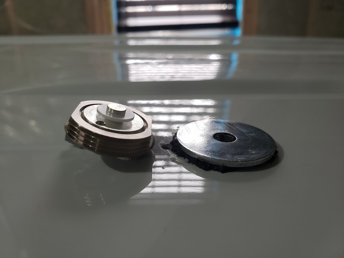

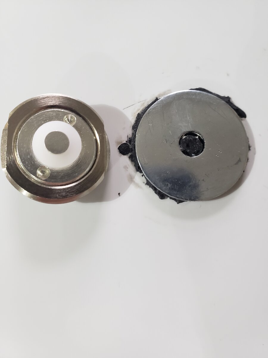

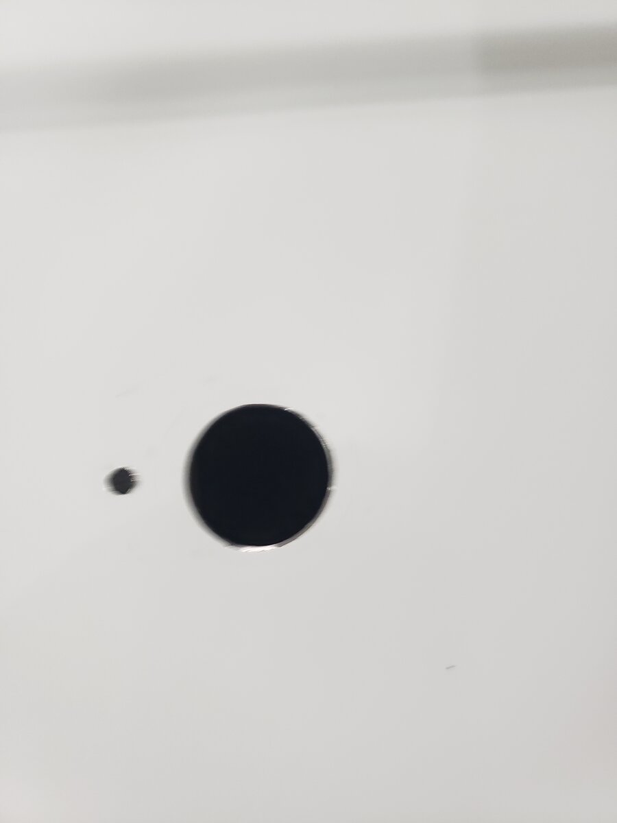

:chug:Update great news!!It was definitely a washer.Came off no problem. 3/4 inch hole.Not butchered at all.Thank God!!!Cleaned off the RTV sealant.Installed NMO mount and rain cap.Very happy!Looks awesome.Even covered up that little hole.Thank You guys for the quick feedback and advice.1 down 2 to go.I think I will celebrate now with a cold beer!

They are the Motorola-style NMO type mount. They were installed from the outside. It seems that someone installed a 3/8 inch hole for the antenna and elected to install the smaller antenna and apply some glue to seal the washer over the hole. When the antenna mounts are properly installed correctly, they don't leak. However, that said, if the glue is securely holding the washer in place, you can either obtain a antenna hole plug for the 3/4 or 3/8 inch hole; or, as stated, use a cap which will screw over the top of the mount.
