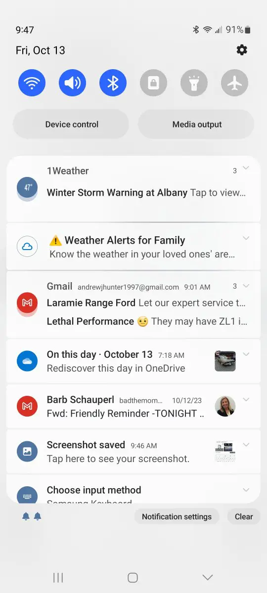

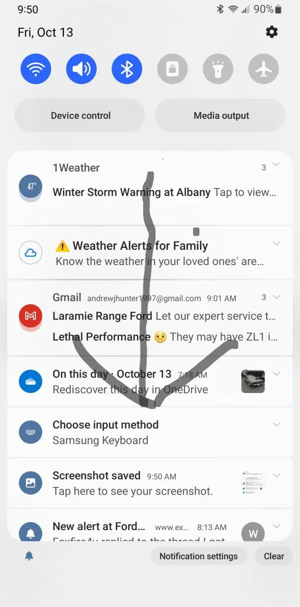

Part:6 turn on your wifi Hotspot. So how do you turn on your wifi Hotspot? Quite simple you see were your notifications bar is. Pull that down. You should see something like this.
Alright if you're here then great pull down where you see your wifi flashlight and Bluetooth.
Now select wifi Hotspot
Make sure you turn off wifi but it should work.

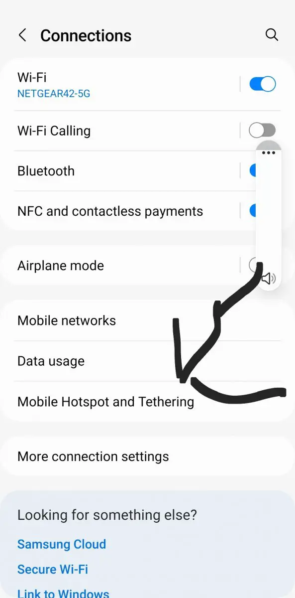

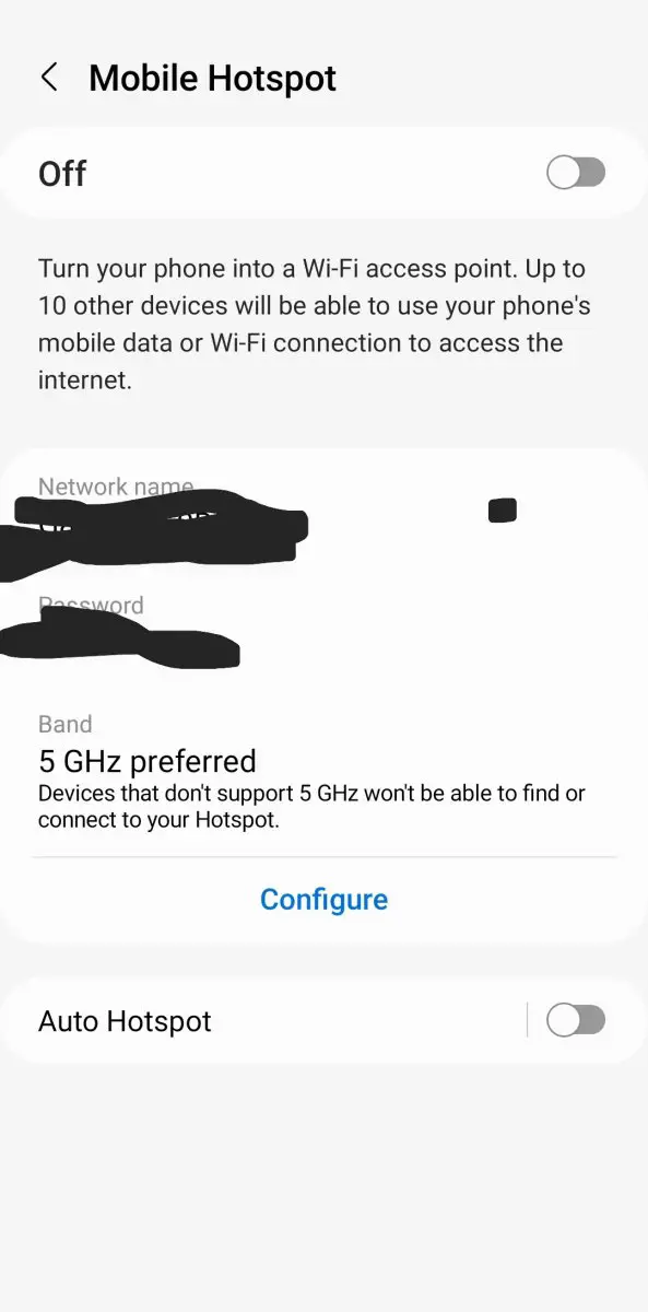

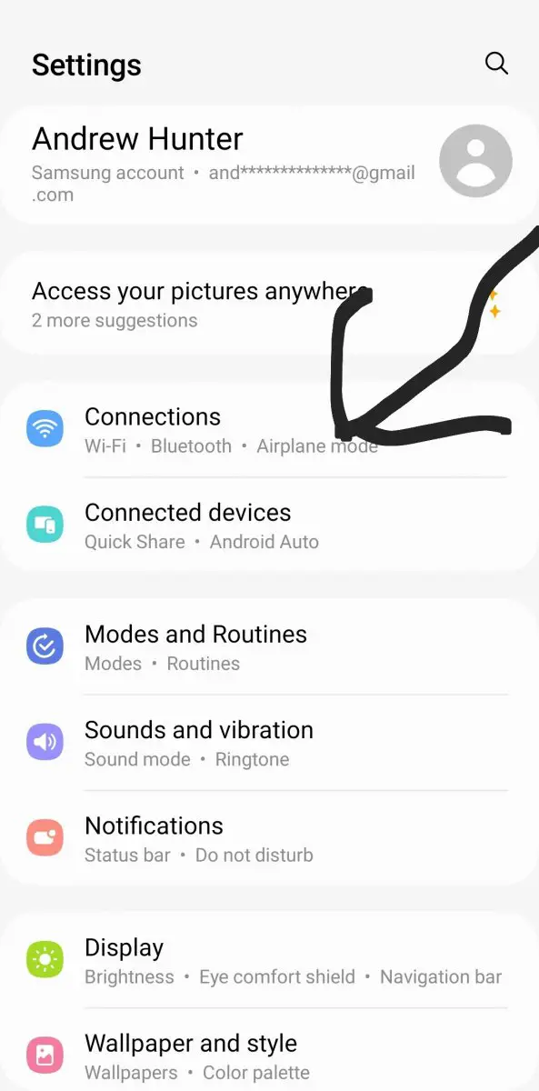

Step:7 get your mobile Hotspot password, your almost there. Go back to home screen and go into your settings, tap on connections then mobile Hotspot you can also turn it on from
here. There is password and username.
Step 8: Follow step 3 instructions just with this username and password.
