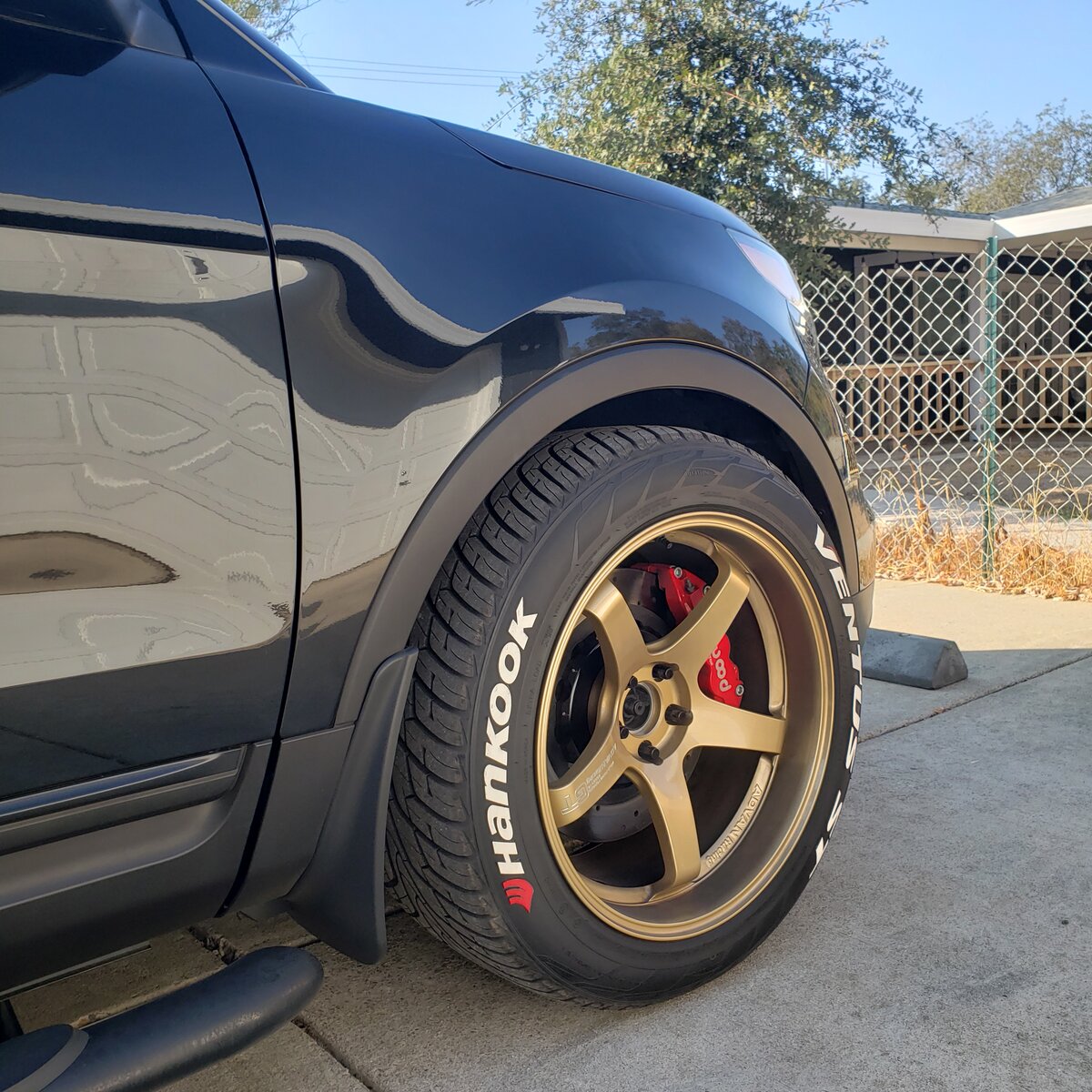

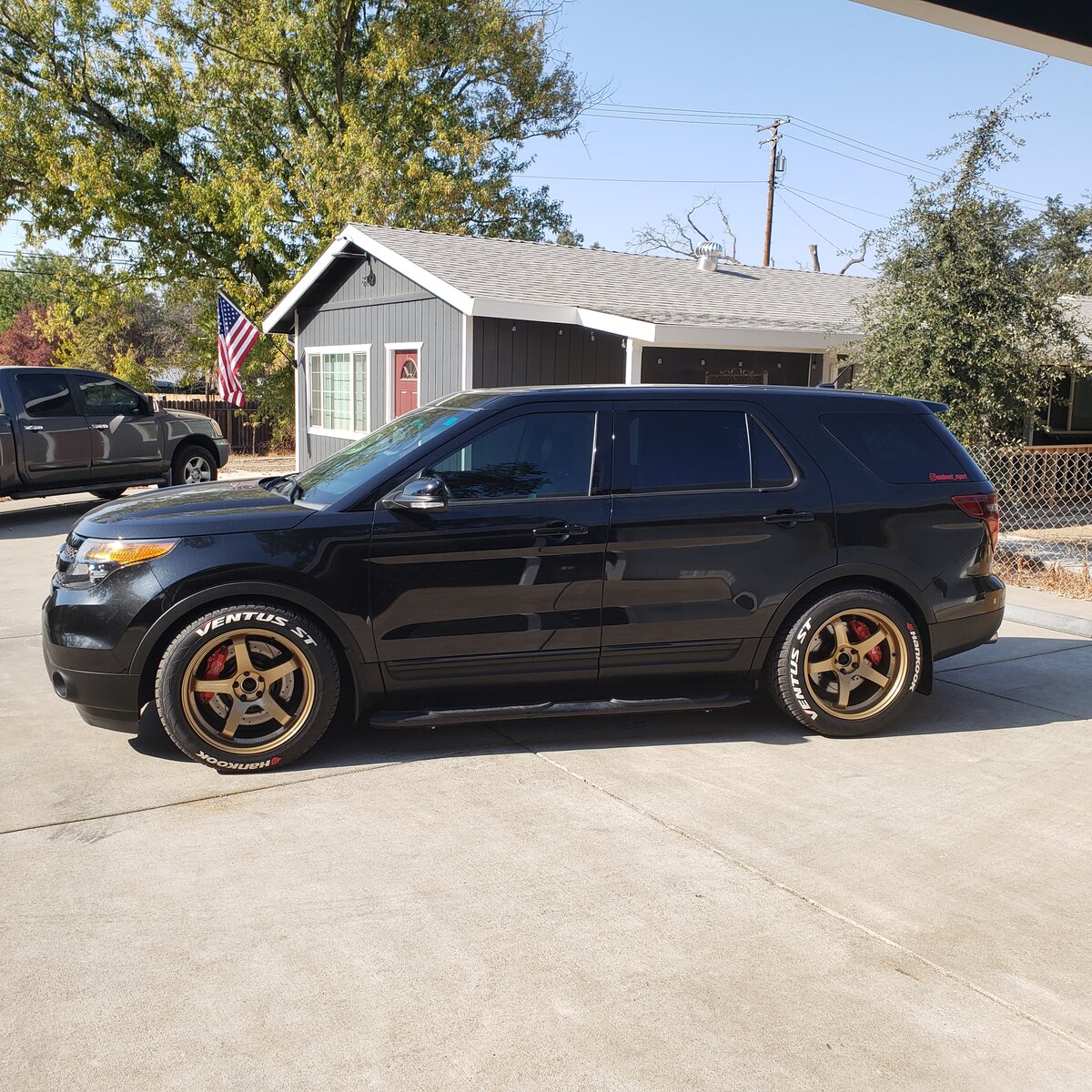

what wheels are you rockin?
20x11 with 15mm offset.
295/45-20 tires.
H&R lowering springs.
No rubbing or issues of any kind.
