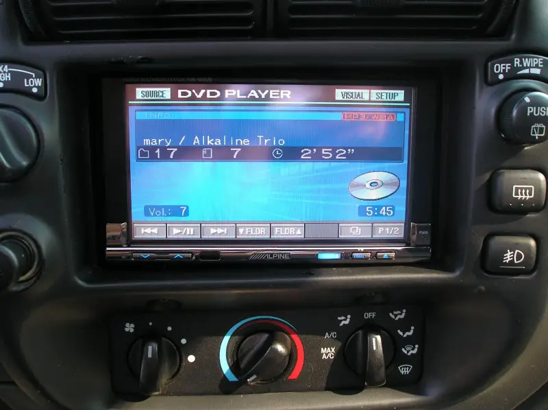

One last attempt, has anyone installed a Double Din (pref: ALPINE W205) in their [2001] Explorer?
i have a double din pioneer d3 and i got my trim kit on ebay had to mod it a bit but it was simple also take the whole bezel out put the headunit in the bezel run a piece of duct tape top and bottom connecting the bezel to the unit top and bottom and it will never slide or move ever
Scosche kit. The sides hold the unit to the bezel, and the rear track slider keeps it secure vertically and positioned level. Trimmed the bezel for a perfect fit (hidden behind the filer plate). Lined the opening with black felt on the rear to hide any hairline openings, even with the filler plate.
I just put in an eclipse deck and the double dins do not allow you to use the trim unless you heavily modify it. I just went with out and it doesn't look too bad. I got the 95-5600 from Metra it would be sweet for that kenwood or the pioneers that do not fold open.
