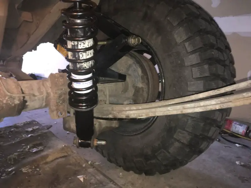

So from What I have gathered here, a cheap way to lift is 1991-96 f150 could spring seats. And 2" rear shackles. They are year specific right?
I do have local scrapyards but they don't let people in who don't work there. So I would have to ask them to pull the f150 coil seats.
And could I just get the shackles from someplace like ebay? I have some 2" lift shackles I was going to use on my 2000 blazer hut sold it and never changed them. Would those be of use by any chance?
Sorry to ask about this stuff but I'm having a hard time finding solid info and I don't want to necro bump.
