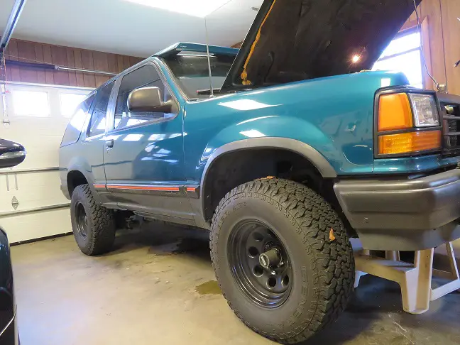

If you could post some pics of your explorer on here too that would be good, so I can see what the ride hieght looks like. Are you happy with your two inch lift? The look, the ride?
should I just get some of those adjustable camber bolts? Or do I need a specific one for a lift, if you got any links or names to any that would help a lot
I'm right in the middle of doing some work on it, so I can't get a pic from a distance or the side, but I took a pic of it in the garage. This would be Skyjacker 132X springs, and OME leaf springs in back with 31 x 10.50 x 15's, with a 15x 8 wheel, 3.75" backspacing. It rides better than stock. Or at least better than at any time in the 17 years I've owned it. I'm running about 3 degree camber bushings. My advice is to run the camber bushings your alignment guy wants to run. Many of them don't want to install the adjustable ones because they say they seize in place and have to be cut out. Moog K80109 is the adjustable.

Your explorer looks sick by the way, I noticed you removed the rocker panels too I'm Probaly gonna do that when I lift it. But mines white so the holes where the clips go looks worse on mine than your black one.
