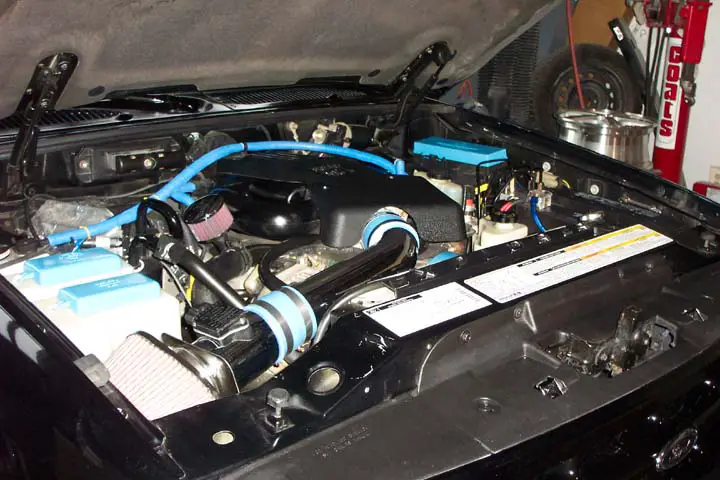

I think only one on my SOHC. Maybe two - its hard to tell in this picture!

Well my SOHC is soupose to have two, but rather then the crankcase breather spewing oil vapor all over my MAS I pluged hole #2 and put in a K&N breather. See photo.
What did you plug the hole with on your intake tube?
a rubber plug and Permatex
