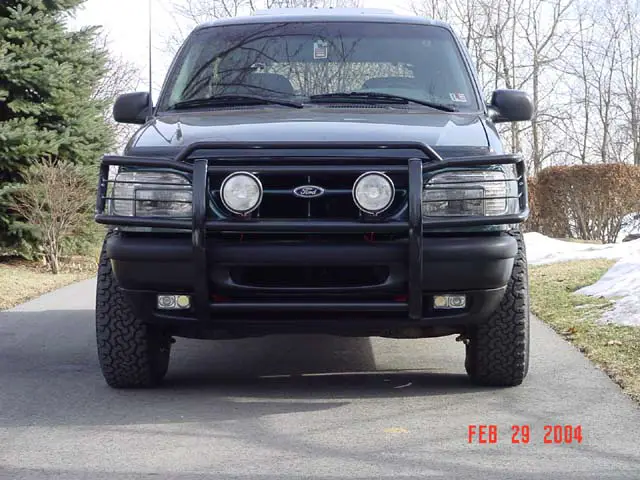

15X8, 3.75BS, 30X9.50 tires
Not the best pic though.

Todd, bout how far do your tires stick out past ur fenders with that bs?
