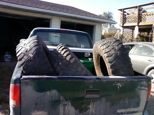

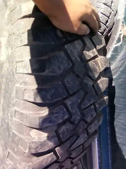

i just got 4 33x12.5x15's givin to me and i was curious how well the 12.5 inch wide tire would work on stock rims... i did the soa lift and coil spacers and the sloped body lift so im sitting with 5.5-6" of lift (this thread isnt about the lift i did so please dont dogg on my choice to lift thanks). Im also curious on if the front tires will rub or not when turning? aftermarket wheels (15x8's) are in my budget come tax season but i can i still use these tire for now with my stock wheels? or will it cause too many issues? and they maybe used but for free i didnt pass it up =D a temp decent tire until i can afford new ones!

thanks for explaining that mark i now understand it all better! and thanks to everyone else for your input and advice. they are now mounted and on the truck and i love the look...but wasnt able to take them fro a spin yet due to not getting my fuel pump today as i expected! thanks again guys
