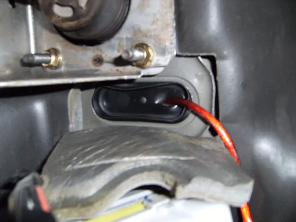

I finally have all the parts in order to install an amp. However, I can not find a good place on the firewall to run the amp power wire on the 3rd gen explorer.
The place I used on the 2nd gen is not there on the 3rd gen. Drilling a hole is not really an option.

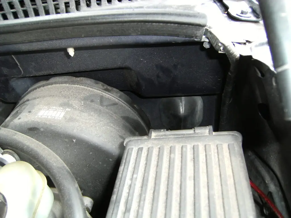

From the engine side look for this on the right side (driver side)

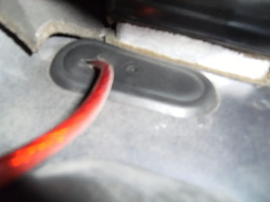

In the back of the round thing (don't know the name lol) there's a black plastic grommet you can punch a hole in that, from the inside it goes here:
There's a flap that you can pull and look behind, like so:
Thankyou, I thought for sure I was going to need to drill a hole.
