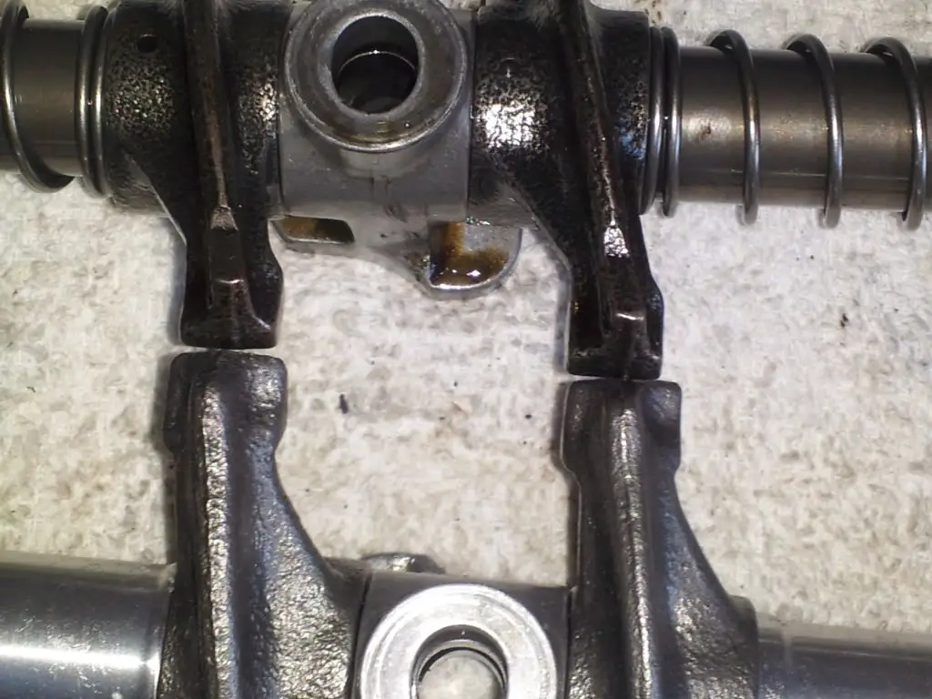

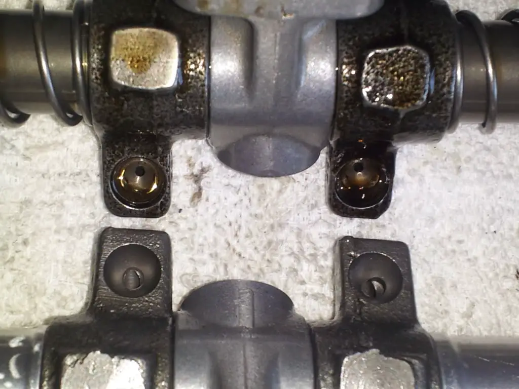

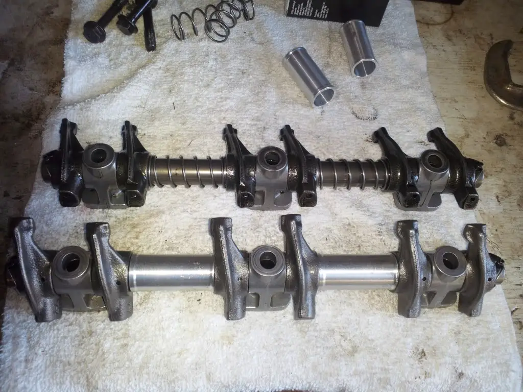

Easy job..i havent had any issues with sealed power other than they are thicker than stockers..not a issue if you run stock spring spacers
So with the sealed powers I will need to order spacers for the springs?
No.the springs are the spacers..they use to make aluminum spacers for performance world..they had to be an exact size to fit between the rockers and alow them to still rotate. Sealed power rockers are thicker and the aluminum spacer had to be cut down..
All irrelevant if you run stock spring spacers..
You can see they are even thicker where they contact the valve tip and pushrod.sealed power and stock comparison
