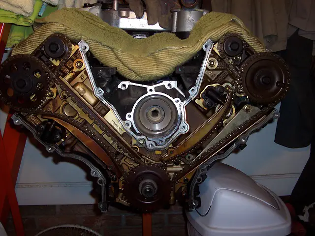

pre-oiler
A pre-oiler avoids dry starts and the wear associated with them. It also pressurizes the cassette tensioners so the chains are taught when the engine starts. However, pre-oiling may not prevent cassette guide failure if it is due to fatigue or brittleness. In my opinion, the only part of the cassettes that should be plastic are the surfaces that contact the chain. Everything else should be metal for strength, rigidity and durability. That's pretty much what Ford did for the modular V8.
Also, the cassettes should be in the front so the engine doesn't have to be pulled to replace them. Unfortunately, Ford cheaped out on the tensioners in the SOHC V8 and made them out of composite material that fails. They used metal tensioners in the DOHC V8.
