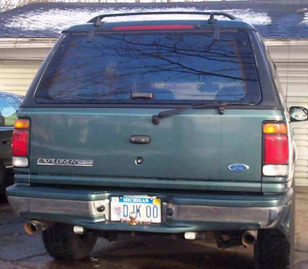

here's mine
Xplorersporto1 hey the exhaust on the x looks bad ass what kind of exhaust are u running and how much did that all cost.(pipes, tips, etc)
biteme, he said that wasnt his truck, but he wanted that look...... my guess is that that is just a dual outlet muffler with shop bent pipes.....
Correct, that is not my car that is the look I want. I am going to purchase a single inlet dual outlet muffler and let a shop mandrel bend the pipes. Does anyone know how much this could cost? Thanks.

How about what GaSouthern is running...he has the dual rear exit side system, couldnt I use that and have the pipes mandrel bent to be stright and then cut them shorter and add some nice tips on there?
The one on the left side is actually between the frame and the leaf spring, you cant get them to go out the corners without doing that. I dont like it all that much just because how it is between the leaf spring and frame, tends to rattle a bit.

Any "good" muffler shop should be able to bend the pipe to fit. I paid a shop $100. for the install w/my muffler.
