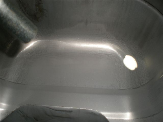

The other item is a dirty gas tank...If the inlet side of the fuel filter is looking like rust/dirty water/fuel the tank is what is causing that...I had my tank boiled out by a radiator shop then lined but it was apparent that the liner did not completely cover the tank because within 2 months I was back changing fuel filters because my fuel pressure was dropping...There is rust in the tank and, unless you can keep the tank full at all times, rust will continue to grow even in a cleaned out tank...And the clogged/dirty fuel filter will cause a leanout condition under load and this will cause misfires depending on which cylinder gets a lower amount of fuel from the injector...

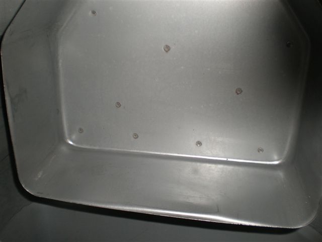

The final straw was when the fuel filter died while driving away from home...The "filter" on the fuel pump doesn't filter out small particulate; that is why you see it suspended in the fuel at the inlet of the filter...But the pump does not like to pump solids and this will eventually kill the pump...So I bought a new tank and got the pump replaced under warranty...
This is what the inside of the tank looked like...And this is the inside of the new tank...

Cool, thank you for the info and the pics. Right now, I am not going to go that deep...only because it is intermittent and there are no codes...being thrown. Also, because it seems like it could be a temperature issue, I like the idea of the intake air sensor mentioned earlier. For the cost of th epart I would like to try that first.
