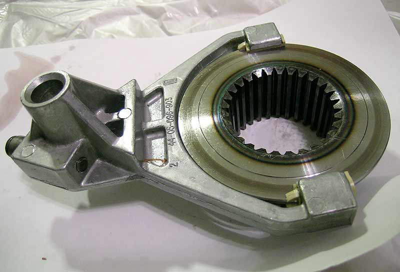

When the vehicle fails to engage 4LO, is it then in neutral even when you move the transmission to Drive? I ask because in order for the transfer case to go to 4LO from 4HI, the shift motor must rotate through the Neutral zone of the transfer case. If the shift fork is slightly bent, or the shift fork's white plastic/rubber bushings are worn out or missing, then the transfer case is probably not making it all the way into 4LO and is mechanically in Neutral.
Below is what the shift fork looks like along with the gear it operates. At the end of the forks are the little white plastic/rubber bushings. These bushings are known to wear out or are just missing.
when it won't engage it is still in 2high, the resetting by disconnecting batt is just to get OD lite off, there are no noises etc like it may be partially engaged
shift fork, gear, shaft and inserts have less than 1000km on them
