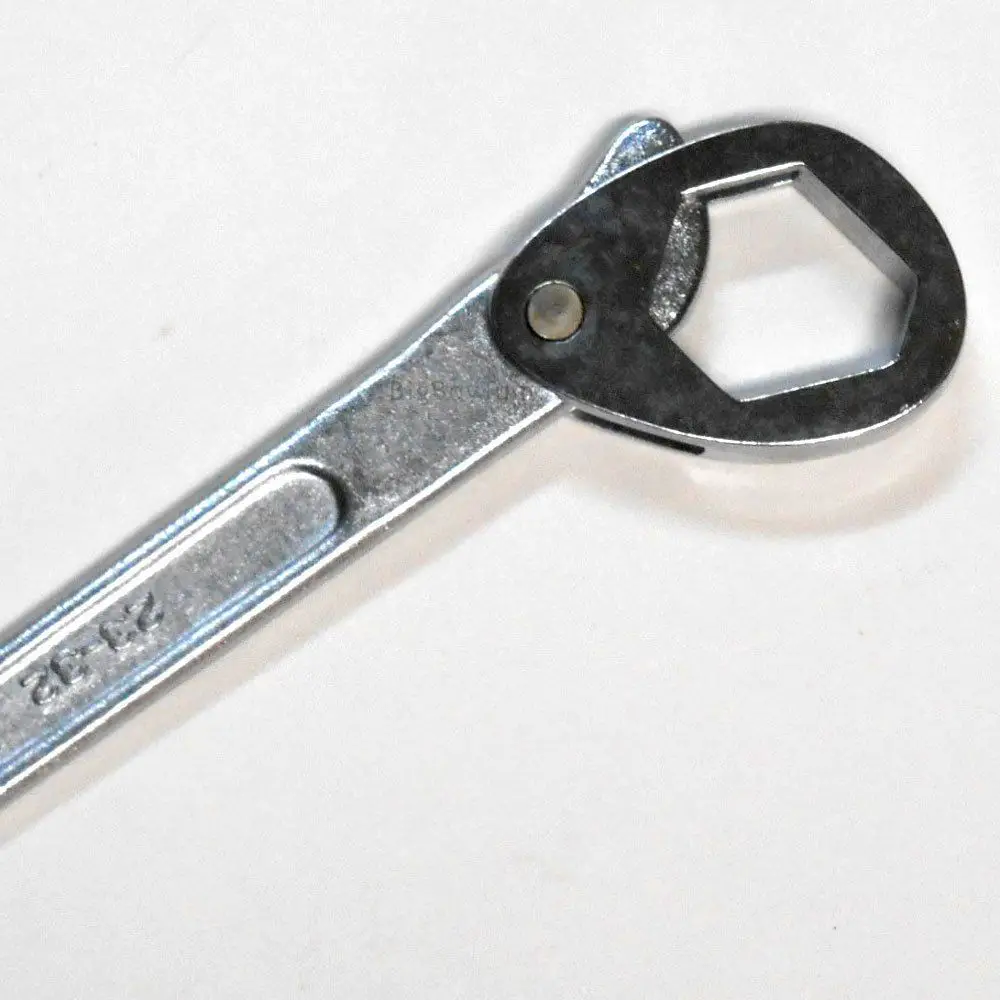

Those little 13mm nylon lock nuts up top are a royal PITA!!! If it weren't for the torch and a wrench I forgot I inherited from my father, I never would have got those nuts off.
The wrench I speak of is called a multi wrench. See the attached pictures. That's not my wrench, but the same type. Fortunately it can be used kind of like a ratcheting box wrench. I highly recommend getting a wrench like this for doing the rear struts!
