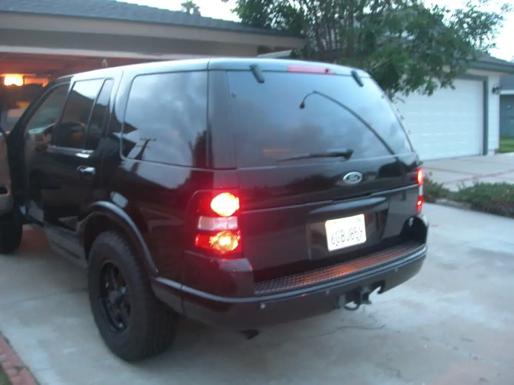

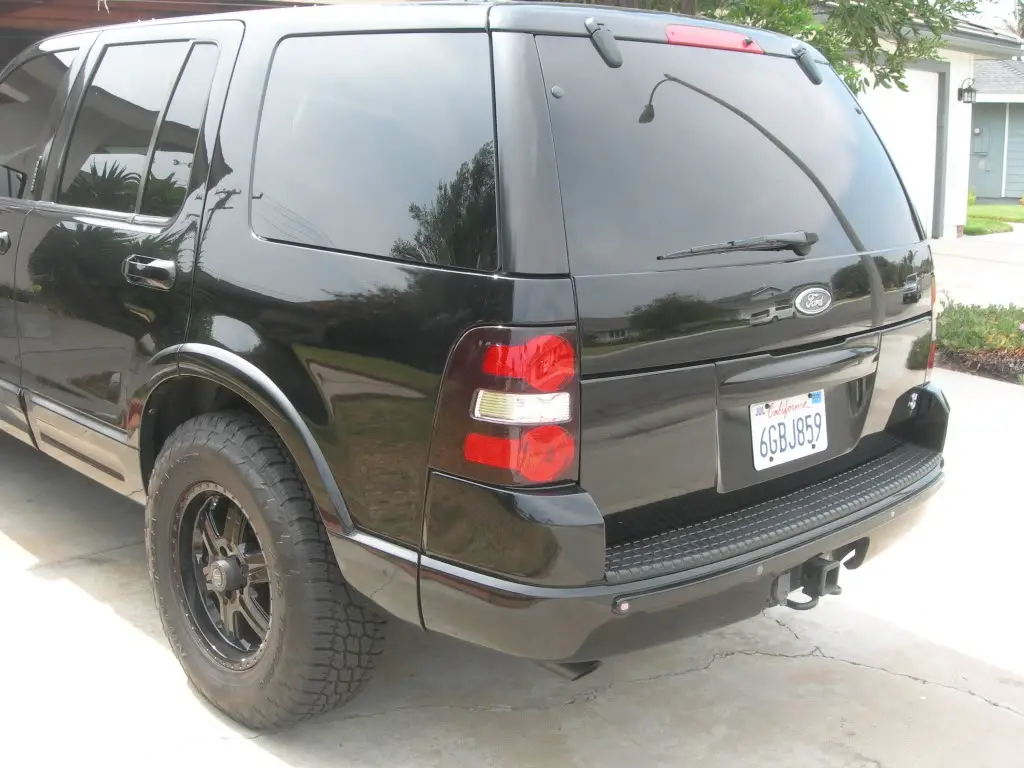

Its been so long since I have installed them that I dont remember exactly but I believe there is an extra brake light and reverse light is different. Also two of the mounts are different. The screw holes line up perfect but the pin style mounts use bigger studs on the 06-09. I ended up making the 02-05 ones work but I highly reccomend buying the correct grommets and pins cause it was a pain to get mine to work but I had already modified the wiring.
looks good tyler keep up good work
Those look great! When you say the correct grommet and pins, do you mean the connectors that hold the bulb and hold it in the lens? If so, that may be another costly addition to this project.

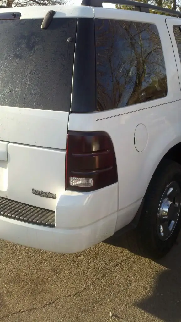

here are my lights. i used a few coats of nightshades, but masked off the reverse lights. maybe something like that would work for your lights.
I like the idea of some paint with areas masked off. that would be interesting to see.

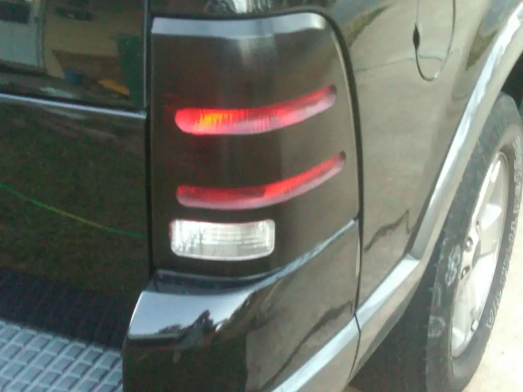

heres mine ... they look better now ... since that pic ive sprayed them with clear

Did mine the exact same way. Did you remove the light on top of the hatch or masked it off? I was in the process of taking the screws out then saw that wire and didn't feel like removing it.
