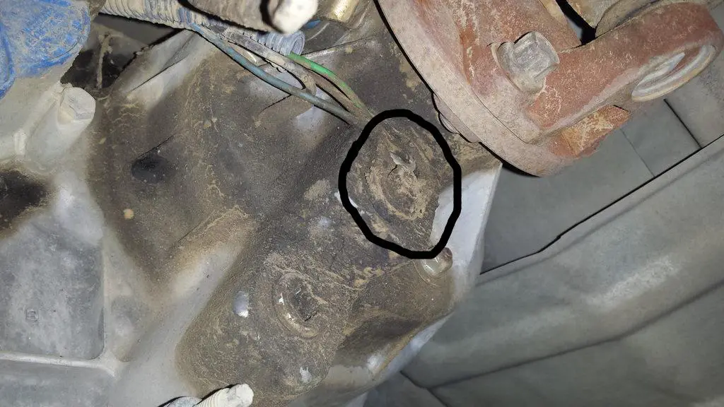

Yeah it'll bind up both ways, sounds exactly like what happened to mine. The Standard Motor Products SC633 (Sorry, can't link directly to it on mobile for some reason) looks the most similar to the sensor I replaced, too. In that case it was located on the back of the transfer case. Here's a pic:
Keep in mind it says it's for the 2-speed transfer case, I'm just assuming we have similar setups.
So I disconnected the 4x4CL module and it no longer binds, feels really smooth and good. Took it for a short drive but def made a different. Points towards sensors as you mentioned.
