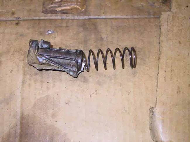

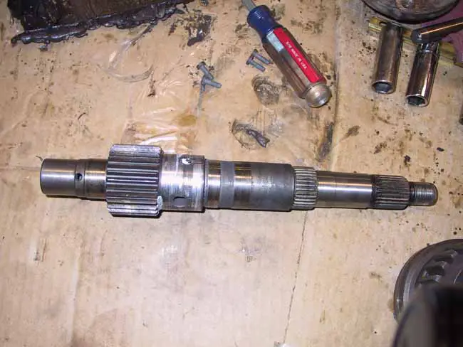

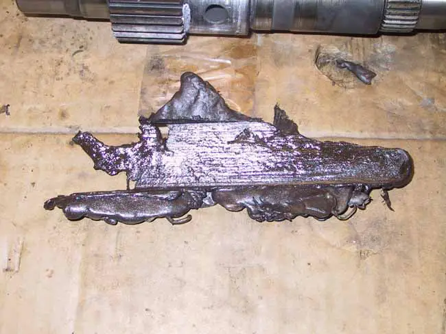

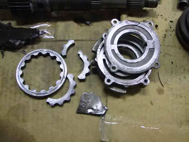

What I found when I opened the Transfer case: Picture #1 is the pump; #2 is what's left of the chain follower; #3 is the 2h to 4h shift fork; #4 is the input shaft.
I think the pump froze
