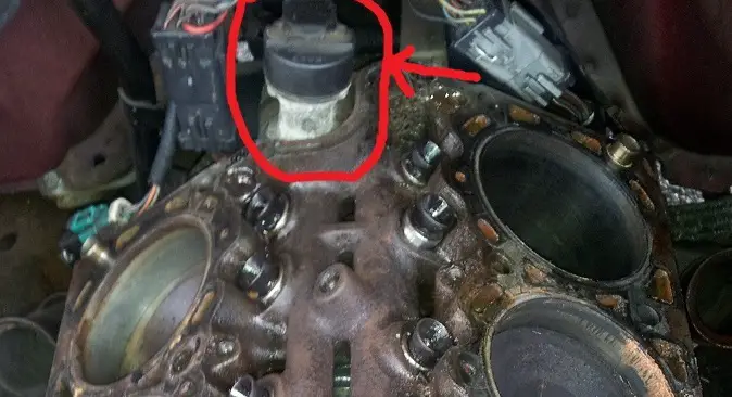

If the chirp/squeal is coming from the rear of the engine/firewall area on a 4.0 (I believe it's in the front of the engine on a 5.0, easier access), then it's probably the CPS.
Definitely will try to take some pictures when I change mine, which is back here in this pic:
