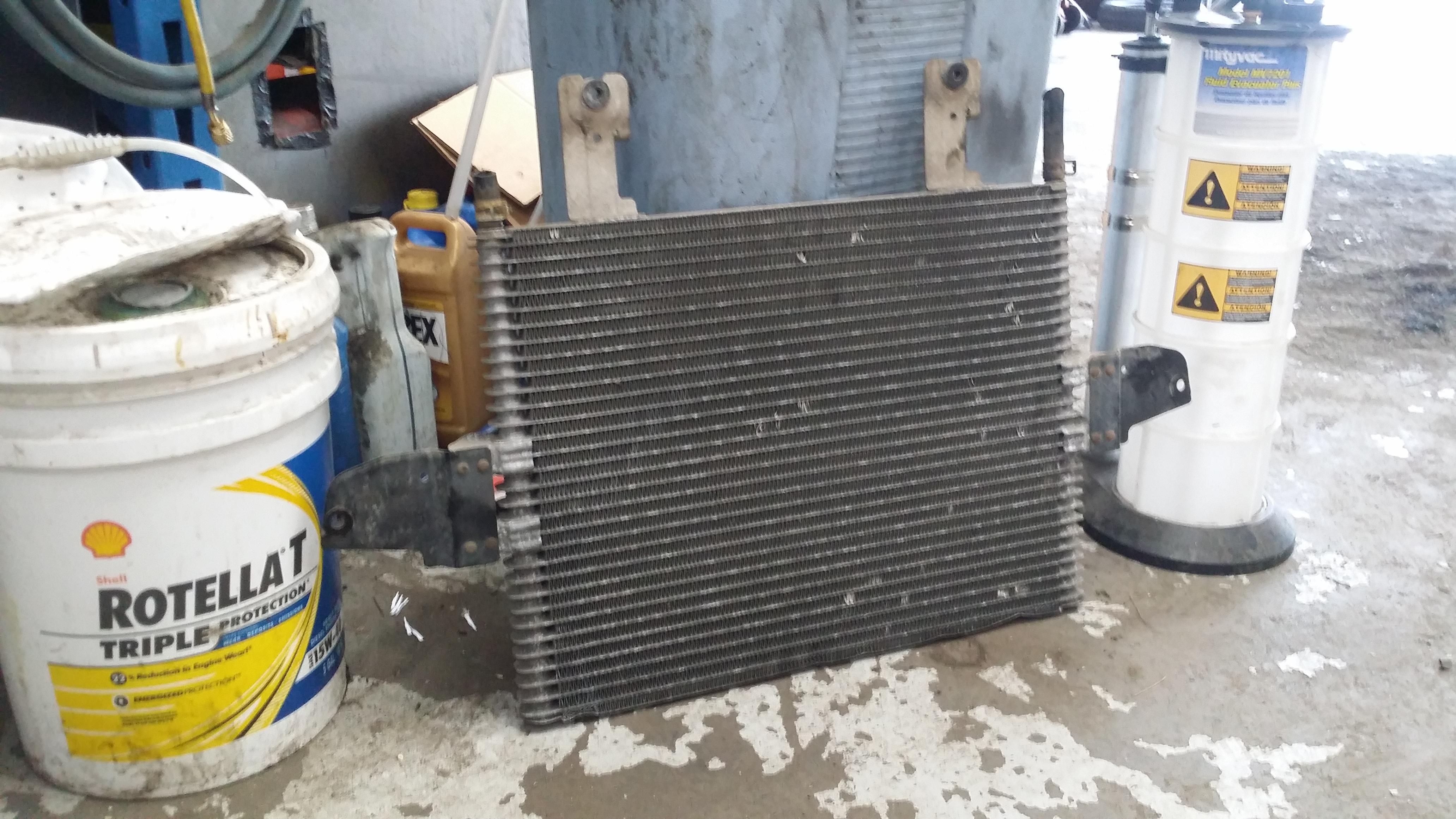

If you want super cooling, bypass the radiator and mount a tall Super Duty trans cooler. BTW, it won't fit without cutting part of the center support under the hood latch.
If your talking a 6.0 superduty trans cooler I have one of those coolers in my shop, it's about the same size as the explorer condenser!
I used an F350 V10 cooler. Don't know if that's the 6.0 or not. Didn't have to cut anything, it mounted right behind the bumper. I did a mini-writeup on it in my thread "My first explorer".

Here's a 6.0 cooler. It makes that 5 gal bucket look small.

Cool, you both posted pictures of the two Super Duty coolers I have. I bought two from eBay, not knowing how big they would be in person. The shorter one will fit without modifying the front much at all. That tall one is huge, as boomin said about the same as the AC condenser. I'm hoping I can move the condenser out enough to make room for the trans cooler to go behind it.

@CDW6212R "I'm hoping I can move the condenser out enough to make room for the trans cooler to go behind it."
Keep in mind that the juice in the condenser may actually be hotter much of the time than the transmission fluid. A matter of which of the 3 heat exchangers ought to receive ambient air first. If I had my druthers, the three would sit side by side, not back to back! imp
True no doubt. I want the condenser in front as much as possible, and the trans cooler lower as space allows. The intercooler will go in front and as low as possible. I figured I would install the two ATF coolers on different trucks, and see if and how much they affect coolant temps, and AC if I try one in front of the condenser. We are very lucky to have so much frontal area to work with.
Wow.... that is one big tranny cooler! I can see why it would take some cutting to make it fit. I mounted mine right behind the bumper and it fit very nicely. And it is at least twice the size of the little cooler that the Ford factory put on the "trailer package" Explorer.
