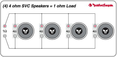

Heres a tip, dont run 2 amps with different ratings to different amounts of subs. Get one amp that can be stable to at least 1ohm, D class will be a great way not to blow your alternator or cause dimming. Now I have to find out the ohms of your subs (when wired) and an amp that will help ya out. Alternators cost around $200 for an X...
Ok the 12" IMPPs have an RMS of 300W each. 300x5=1500Watts MAX RMS that you would want to run to them (if you dont want to blow then in under a couple months). So you take all 5, you can make >1ohm load(probally .75ohm load, since 4ohm subs can make a 1ohm load, like this...
