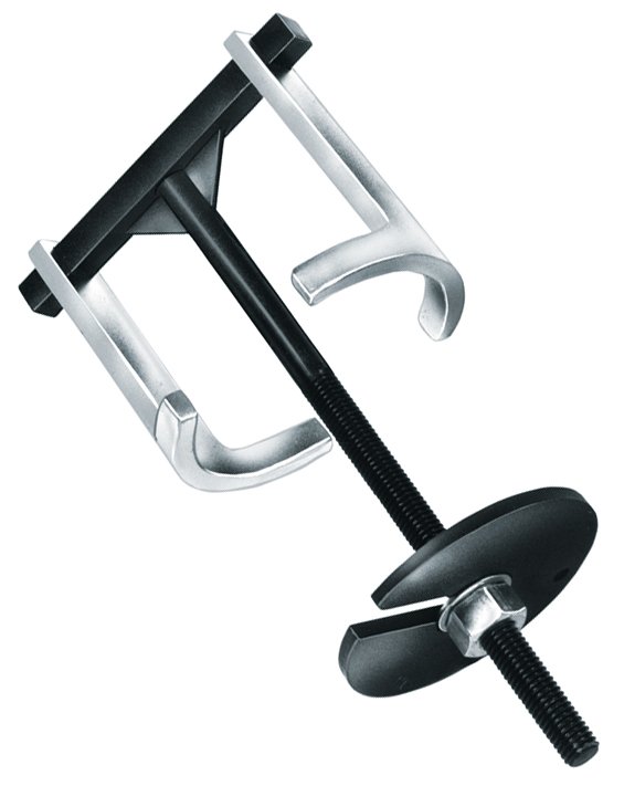

The good part is you need no special tools (maybe a clutch press),
the bad part is to identify worn intenal parts, how bad they are or to reuse them.

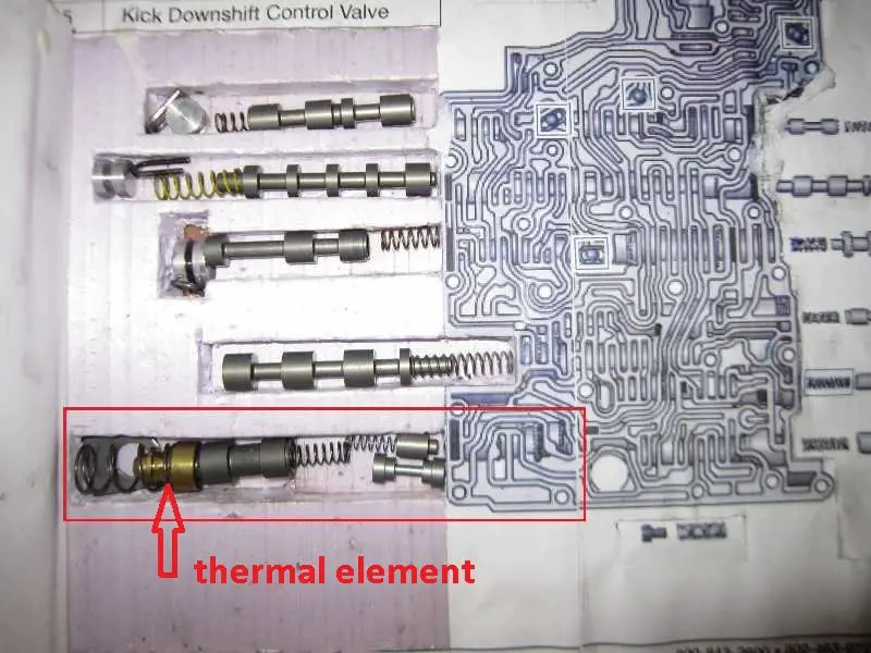

It is also important to eleminate the thermostat oil bypass valve for the oil cooler (inside valve body).
It doesn't matter if the oil is continiously cooled, many 5R55E's died of heat.

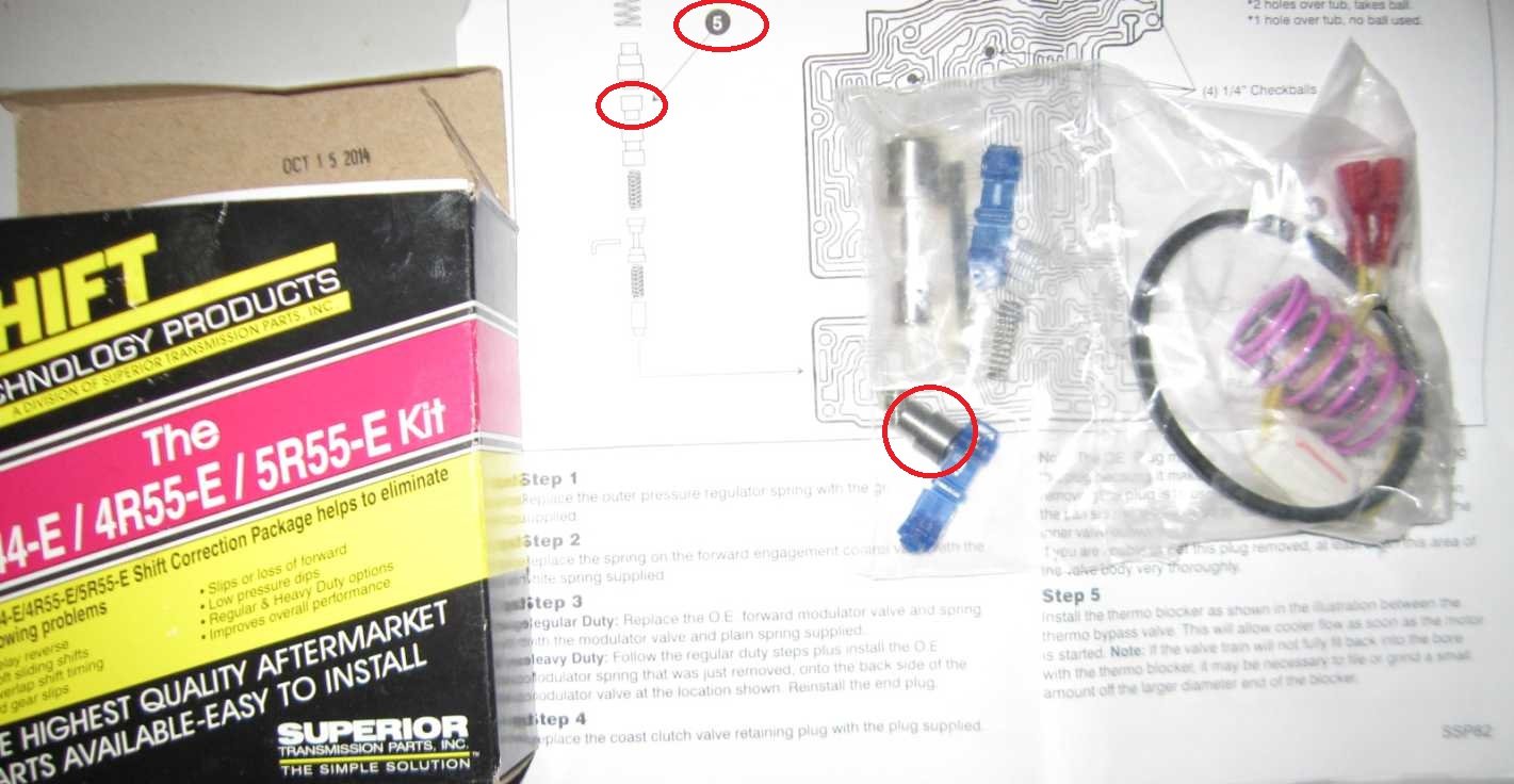

There's a Superior kit with the little part included which opens the oil cooler circuit permanently,
only use this part of the kit.
A additional inline filter inside the return cooler line is recommended too.
