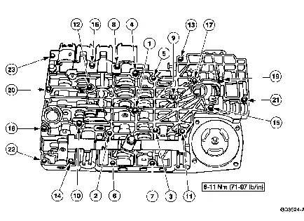

The car is running fine but somewhere on this forum I read that I should re torque some bolts while the pan is off.
Please could someone post which bolts and what torque figures.

hi there, lucky i found you here lol, why not come on over to the uk section with us, with regards to the torqueing of nuts i think your talking about the drive bands loacted on the left as if you are looking up at it next to the shift cable/shaft, two nuts sticking out, one does the overdrive band and the other 2nd gear band.
You probably saw the suggestion to re torque the valve body bolts because they are known to work loose over time leading to valve body gaskets leaking.
