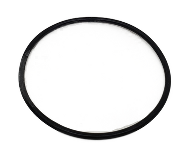

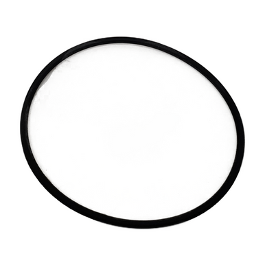

Is this issue internal with the O ring?
I would bet the o-ring is worn and i would change both of them (OD and intermediate).
Push the servo cover in a little (maybe with a big clamp), snap ring out, release clamp pressure
and the cover should came out (inspect cover for crack).
Clean the groove for the snap ring, oil the new cover o-ring, seat the snap ring, pushing it in his groove
to fit properly.
