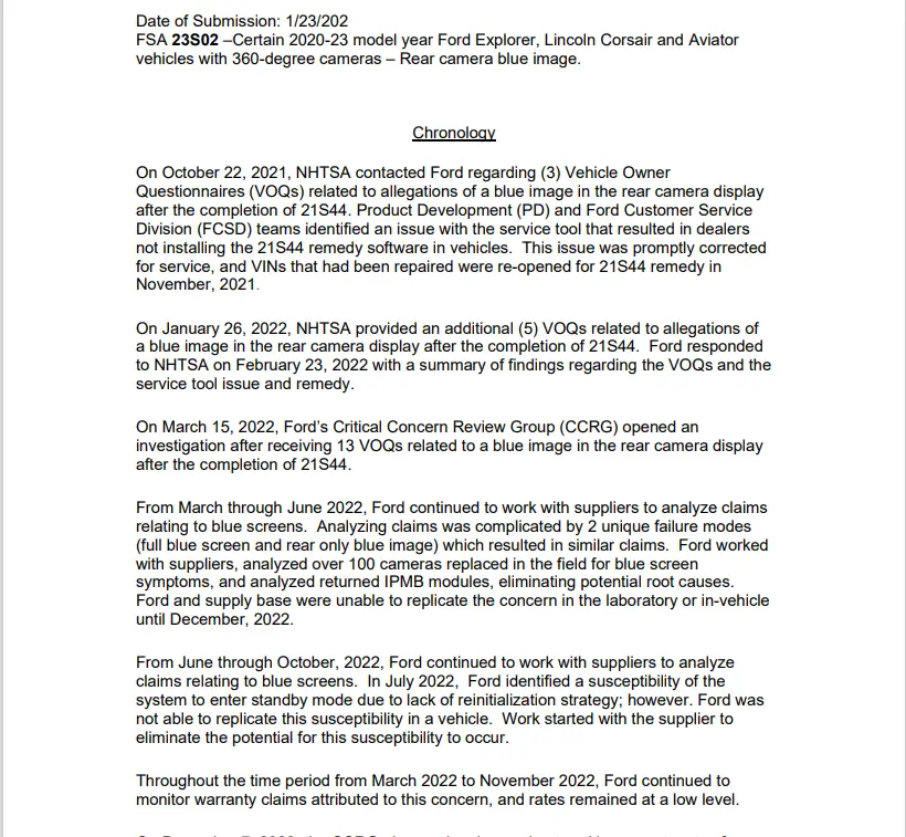

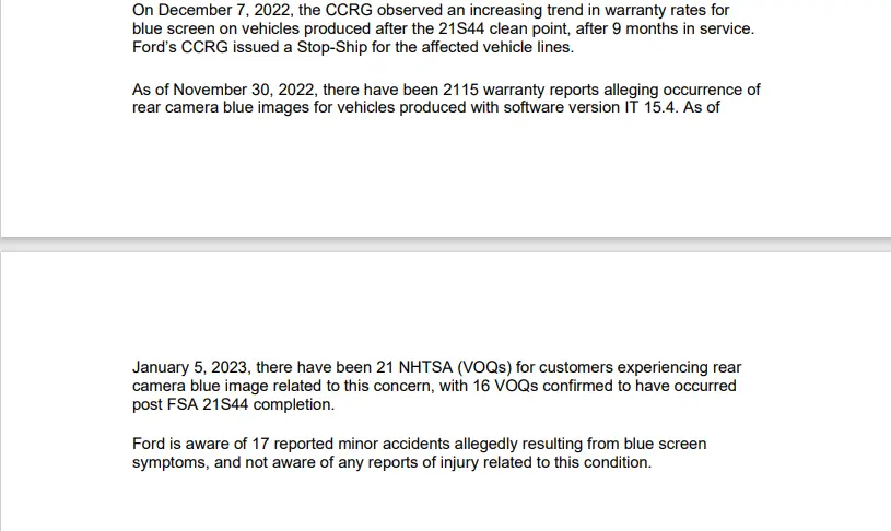

FSA 23S02 - Rearview Camera Issues
The affected vehicles include 2020 to 2023 model year Ford Explorer, Lincoln Corsair and Aviator vehicles.
