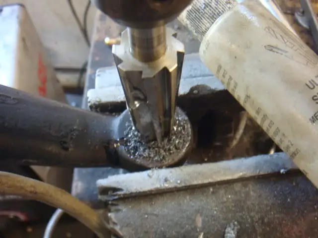

Here's what he's looking for. It has to have the 7 deg taper or stated differently 1.5" per foot.
I borrowed this one.
I used it when I relocated the TRE from bottom to top.

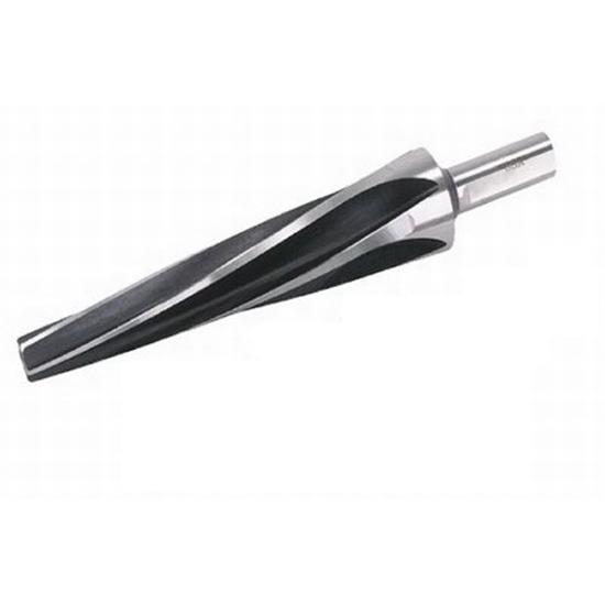

Thats exactly what im looking for! money shot right there! now does anyone have that i can use is the major question....
more of a description here with pic
Diameter Small End0.500" (1/2")
Top of Taper1.000"
Bottom of Taper0.464"
Degree of Taper7 degree
tapered reamers for proper fitting of ball joints to spindles, tie rod ends to spindles, etc. These have 1/2" shank. The 1-1/2" per foot reamer, also known as a 7° tapered reamer
Measures a little less than 1/2" at the small end and 1" at the big end
