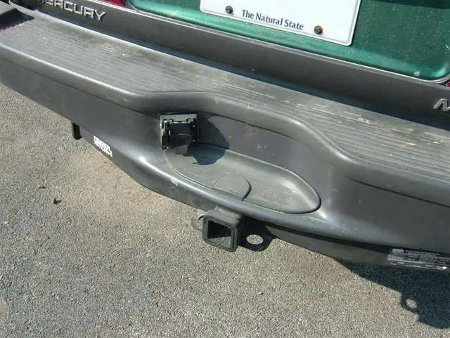

No gen II Explorers were wired for a brake controller under the dash. I just got done putting on a brake controller and plug- I had to wire it all from the front to the back. You can wire a relay to power your reverse lights if you don't feel that your stock wiring will do. I think it should work though. Run the power wire to your battery post or to one of the posts on your power distribution box. Be sure to fuse it with a 30 amp fuse or circuit breaker. I had to get creative on where to put my plug because it was so big, so I cut a hole in my bumper by the step part to mount it. My bumper is charcoal grey so it dosent look bad.
I did the same with mine. I drilled through the bumper to the left of the step. Mine is also black and it looks very nice. The 12volt I wiired directly to the battery with a 30 amp fuse. If you have amber turn signals on the rear you will need a special adapter for the lights. I also installed my brake controller and had to drill through the firewall to hook up the wiring. It's an easy job once you get the correct parts. I used alot of zip ties and the black flexible wiring covering going from the front to back.
