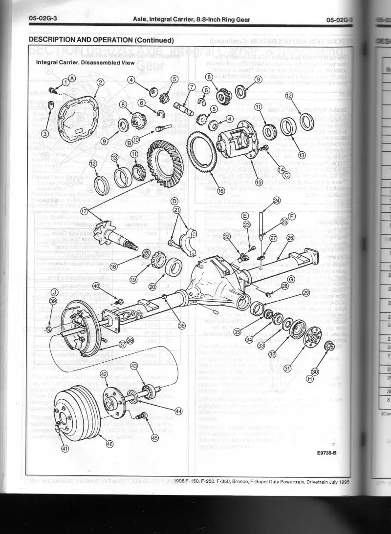

hello im going to be replacing my rear differential bearings dose anyone have a dieagram of the differential I have looked and can not fide one I have searched on here as well and nothing came up thanks in advance bobby

Here you are, Bobby! Source: 1996 Ford Truck Shop Manual
Just picture yours without the axles on each side as ours (2002+) are only the center section with cv shafts.
thanks duranged84 and the bearing i'm changing is #11 correct

#11 are the differential bearings which support the whole works. But they also establish the tooth contact pattern. Manufacturing tolerances on tapered roller bearings are such that the new bearings may cause the clearance between the gears to change a bit. The thickness of a hair (0.002") difference can be enough to cause gear noise. It is always best to check the contact pattern with Prussian Blue before buttoning it back up. If the contact pattern is not acceptable, shim thickness must be changed. The shims not only locate the ring gear correctly, they also must preload the bearings a specified amount.
Sorry I could not show only the center section of the axle, but the "pumpkin" parts are the same in Explorer. imp
