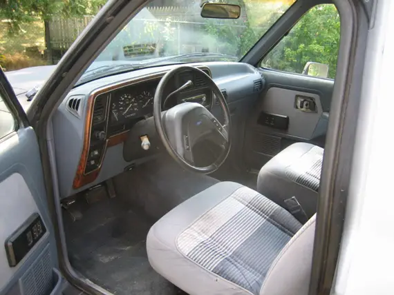

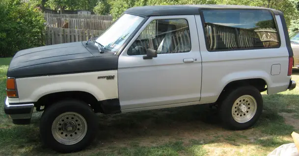

Posting pics of my 89 B2 XLT and the donor 94 X sport 4.0L auto trans with manual hubs and manual transfer case. Plans are painting the whole truck white, doing the engine/axle swap, 3" body lift and bigger tires.
