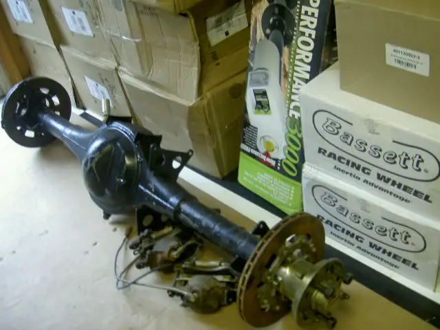

Need some advise on this 9" ford housing only. This guy put it in his dirt track stock car only to find out it was not permitted because the rules state only rear drum brakes. It was on one of the lower classes. It comes with disc rotors and calipers, wished I had of asked what make of caliper, but every one was in a hurry at the race car shop. stainless steel brake lines, racing axels, I think he said something like mosher? Look at the end it seems to be some kind of axel retaining thiing. might be made our of brass. I know I need more info, I can call them and ask about more details, they were just to busy on Fri morning so I did not bother them. It is also the same length as the 8.8 I have under the B11 now. The rotors would be in the way of the springs I think, so I would have to have a link suspension with coils. Bottom line $450 Is this a good price? Could I build the same axel for less, remember the length is the same as the 8.8 maybe an 1" longer.
If its what you want, then its a good deal. :D Check the lug pattern because there is no telling what it is. I would guess 5 on 4.5 but since its got Moser shafts the other holes could be chevy pattern (5 on 4 3/4). Also make sure the axles are 31 spline (probably are). That is a late model non-banjo style housing which is really strong. Overall id say its worth what they're asking even with no 3rd in it.

I'm willing to bet that that axle is set up to use Willwood brake calipers. There's probably a lot more work in the axle tube itself than is apparent to the eye (tube straightened & strengthened). The Moser axles themselves are probably worth $450. The hubs are pretty funky but changing rotors will be a snap. If you're seriously interested, try to pick a time when they're not so busy. That way you can get the "low down" on the entire assembly. As mentioned above, 9" third members are pretty easy/cheap to come by. There were quite a few Ford apps that used that axle.
