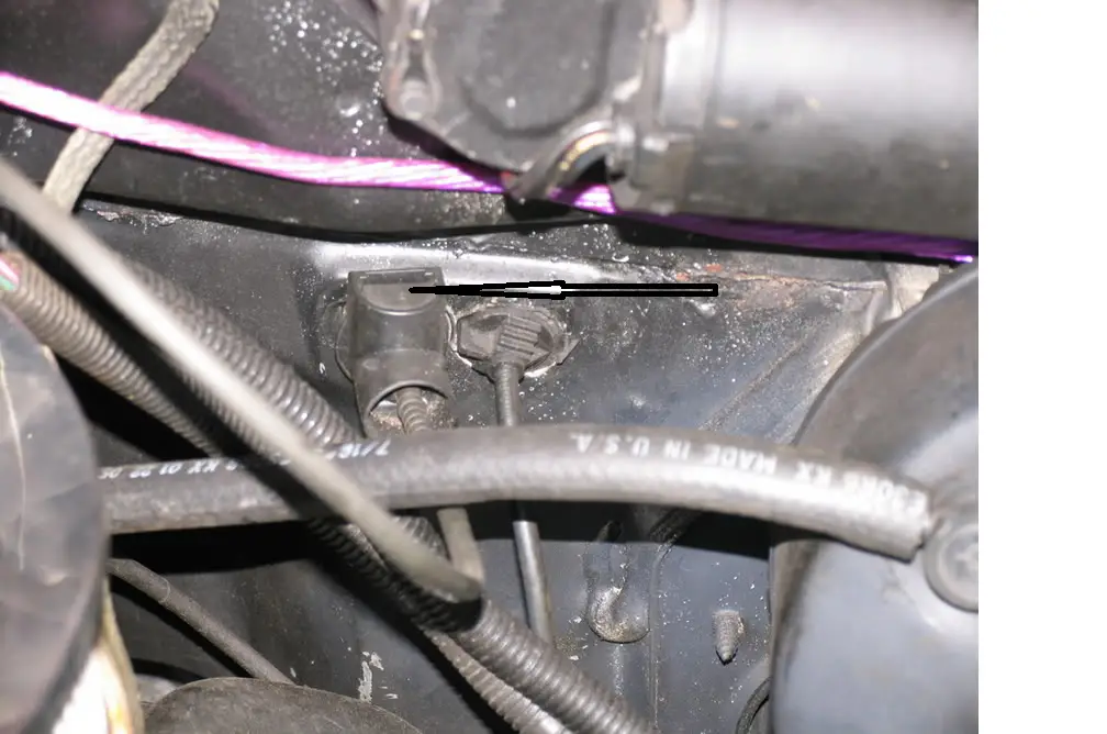

Sound to me like the transmission kick down cable needs to be readjusted.
The trans should not downshift until you are nearly at WOT.
Simple: Press this "D" shaped retainer down with one hand and hold down while pulling the cable out about 1 inch. Release, and then go press the gas pedal all the way to the floor. DONE! :D
